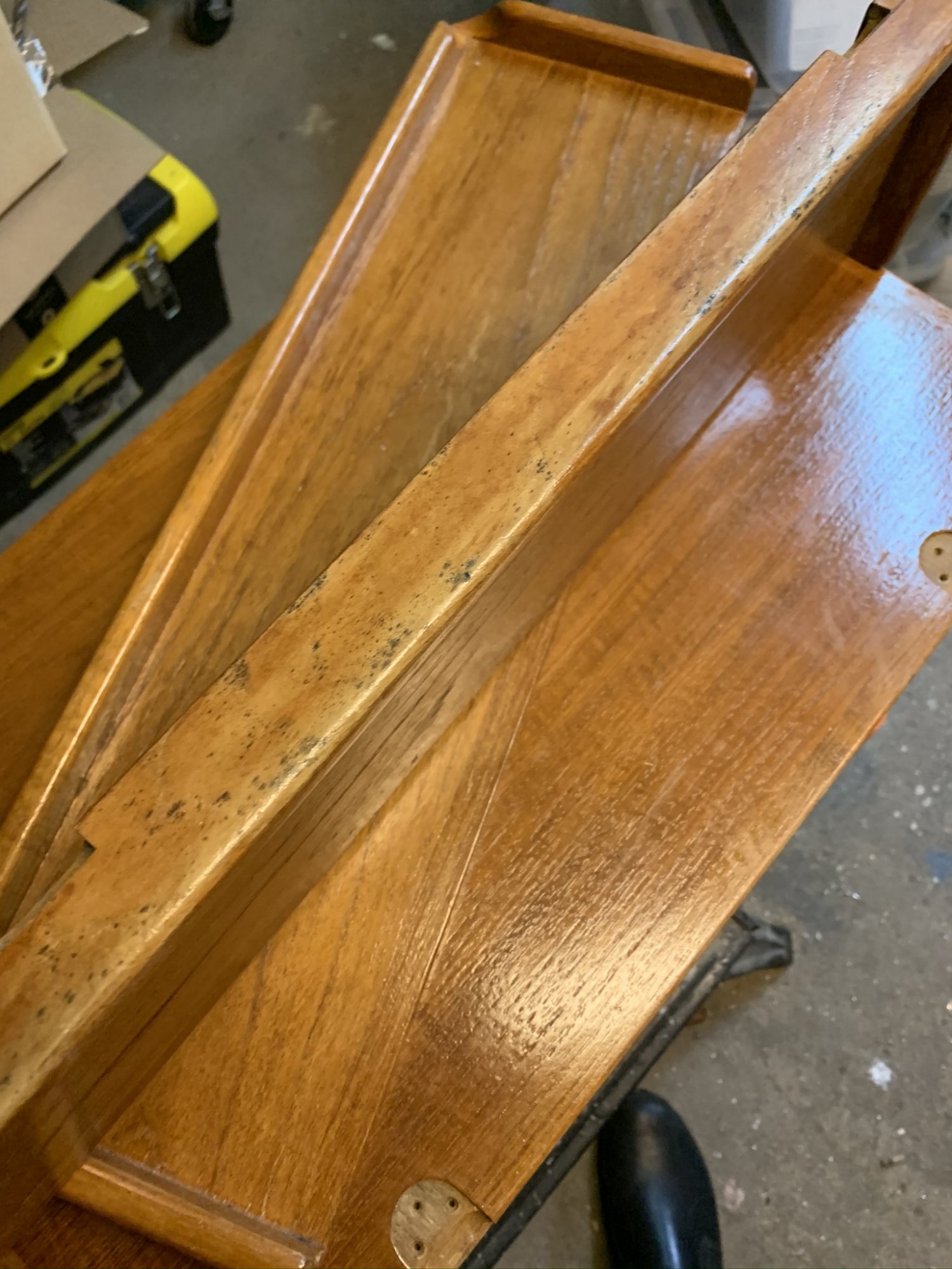

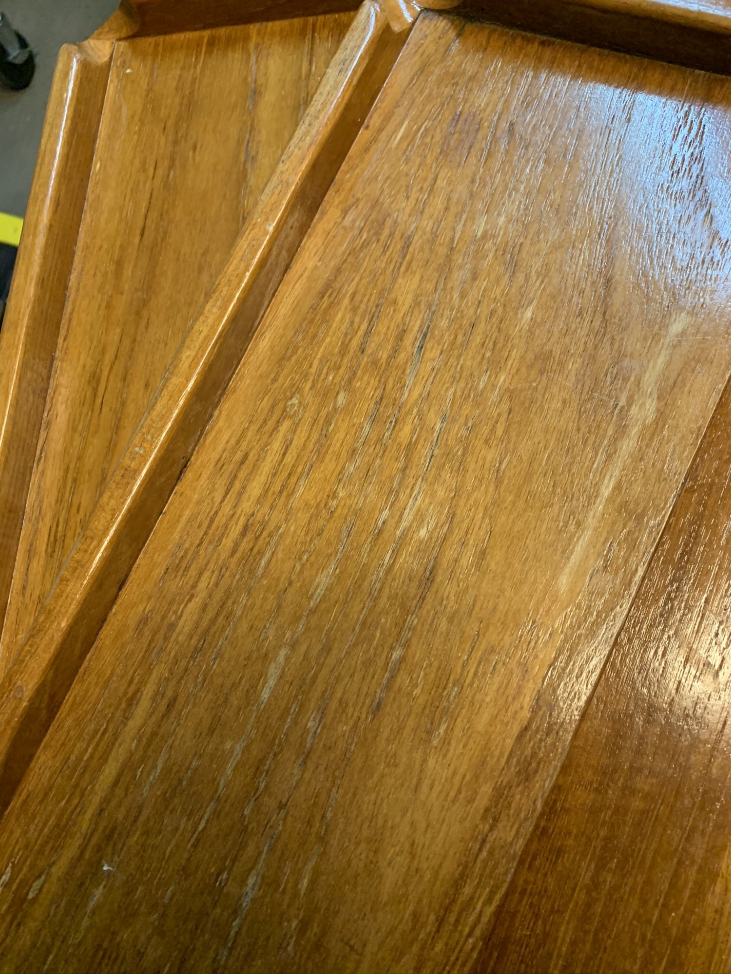

My cockpit table is starting to look a little beat up and the finish is degrading in some spots, and I'd like to freshen it up. I have some spar varnish on hand. My question is whether I can just scuff sand it and degrease before giving it a new coat, or should I sand it all the way down?

Yes, you're on the right track.....degrease, and sand very lightly with 400 grit, vacuum & wipe, and apply a couple coats of your favorite sealer.
You got this before you needed to completely refinish!

If you want to get rid of the gray streaks the only way is to strip all the old finish, sand and maybe bleach the wood. Then start over.
FWIW, I've grown fond of Epifanes Wood Gloss finish. It seems to hold up well to sun and can be recoated after 24 hours. If recoated within 72 hours no sanding is necessary between coats.

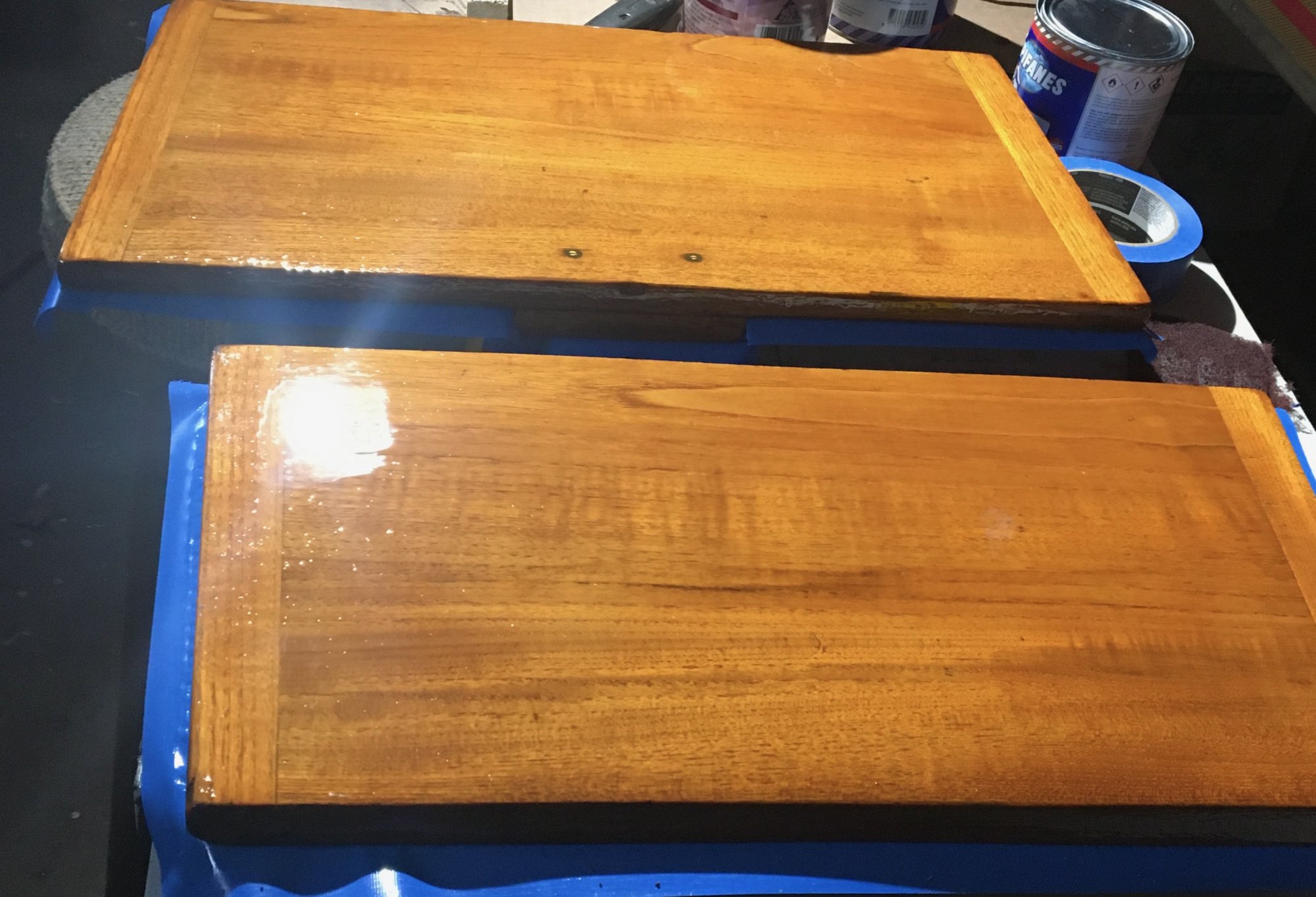

Just give it a good flat sanding with 220 or 320 (320, more time = better finish). Use a block and make the old finish an even fog or mat sheen. If you want the best finish with no more work, use a 4" foam roller and plastic pan to apply and even coat. Roll and lightly tip (with a throw away foam brush) the top, brush the small bits.
As you have time, let it dry at least 24 hours, flat sand with 320 or finer (or just a 3M wood finishing pad) to an even fog again, and roll and tip again(using your pan of varnish, roller and brush that you covered and left in a cool place).
It's not likely the under side needs recoating but do that last after the top has dried. There's very little time and effort in this. The time is in the drying.
