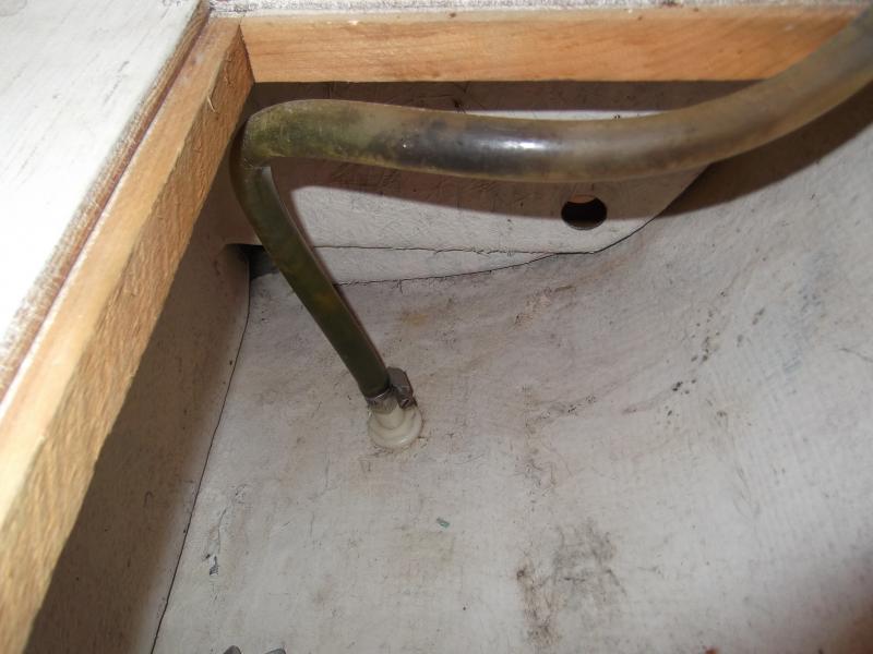

I made some modifications to my boat that leaves me with a through hull fitting that I am a bit concerned with. My boat is one of the very early 1972 models that had the sink forward of the starboard bulkhead. It was just about useless and I would much rather have the storage space so I took it out. I was also having trouble getting through the bulkhead opening which for me was dangerously narrow. After removing the sink I removed part of the bulkhead which serves no purpose other then it was supposed to provide some privacy from the head. I realize that the bulkhead is used to support the chain plates but the part I removed has nothing to do with the support structurally. I did not want to make any modifications to the compression post for obvious reasons. This modification leaves me with a through hull for the sink drain. I really don't want to disturb the through hull since it seals very well and I don't want to get involved in fiber glassing over the hole but I'm not sure how to secure it. Would you leave it there and just put a wood plug in the tubing with a hose clamp? Could it be used for a sump pump outlet? By the way if anyone needs a sink and hand pump they are welcome to mine. Just let me know. Thanks very much for any replies.

Don't use it for a bilge pump, that would siphon water into the boat. Bilge pump outlets need to be above the water line. Can't see in the picture on my phone, is there a sea cock or valve on the through hull? If there is, you could just screw in a pipe plug. If not, you'll have to seal up the hole.

I really am not completely happy with removing the through hull that is in there now since it is very solid.
Maybe I'm misinterpreting the picture, but from what I see there is un-reinforced hose running to a plastic fitting with no seacock. I'm afraid I could think of some adjectives for that other than "solid". Certainly seems like more points of failure than an epoxied over hole.

Yes I have some answers. All of this boils down to if I am going to be comfortable with whatever I do. Good or bad, the configuration I have is from the factory. No it does not have a seacock which in itself is a bit flaky. I'm sure I could affect a repair using glass as is described in the reference for West Systems but I am not sure I shouldn't leave the through hole alone and somehow plug it. I don't want to beat a dead horse here and I really appreciate all your input. One final question. If I retained the through hole as it is and added a seacock would that be adequate? What about adding a seacock and filling the through hole from the outside with epoxy or silicone? I don't want to give the impression that I don't regard everyone's advice. I'm just looking at options that don't rely on me doing something for the first time on such a critical component. Thanks again.

Hard to tell but it looks like a nylon fitting. For underwater only Marelon should be used for a plastic fitting. You are making this into a much bigger project than it is. Take out the fitting, prepare the surfaces with a little sanding, lay up some layers of epoxy saturated fiberglass cloth on the inside extending the cloth well past the diameter of the hole. Once it cures, do the same on the outside, when that cures sand it smooth put a couple coats of epoxy over it extending past the repair as a barrier coat and then paint it. You are looking at maybe two hours worth of work and about 40 bucks of materials. If you can find a smaller quantity of epoxy than a pint or a quart it may cost less. As long as you mix the epoxy in the right ratio you will not have any trouble at all. After doing this you will never be afraid of working with fiberglass again, it can be messy but it is easy. Get some tight fitting nitrile gloves so you don't get the chemicals all over your skin.
Putting a ball valve on a nylon fitting is not recommended, they don't have the strength, and you will always have something sticking up that could get hit and break off, if that happens you will really be in trouble. Marelon is glass filled plastic so it has a lot more strength. It is a lot whiter in color than nylon. Until you do the modification, get a tapered wooden plug and tape it to the fitting so if it breaks you can plug the hole.
