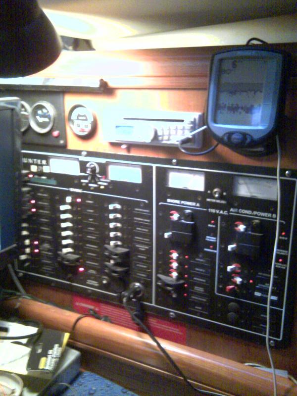

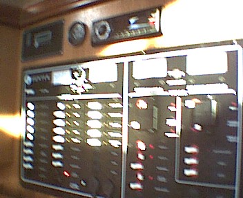

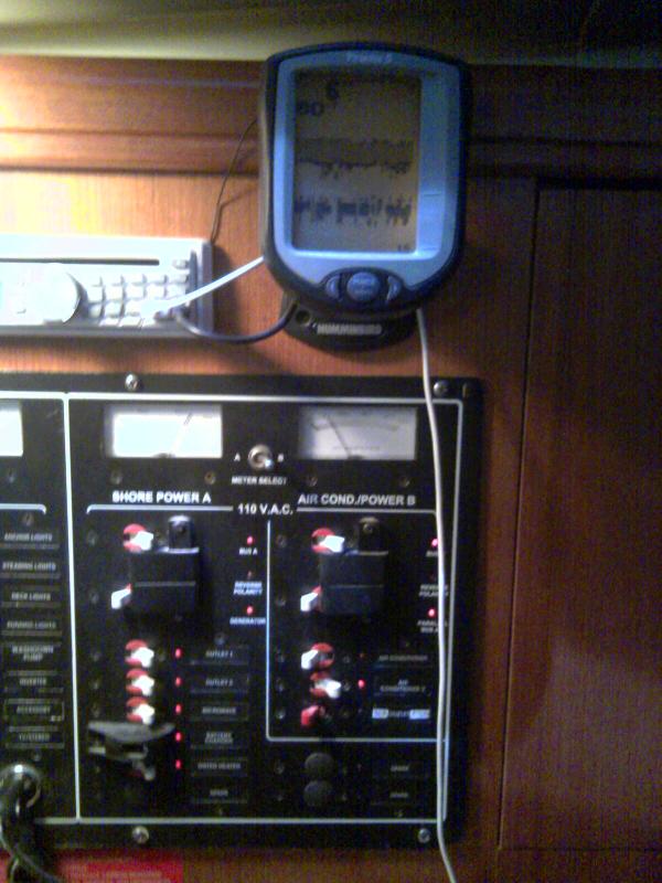

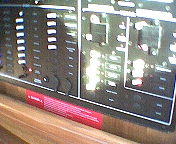

Check out and study the pictures of my breaker service panel. Your panel does not have to be as elaborate but maybe it can help give you some ideas on what route to take. Notice it has a dedicated 12 volt side...Then it has a dedicated 120volt "A" side and a dedicated 120volt "B" side. Notice in some of the pictures "A" is feeding the "B".... Reason is...I was visiting a marina that only had 30amp service available. So only one 30amp power cord could be used, it was plugged into the "A" side 30amp service inlet at the stern of boat . So I then had only 30amps available. So now I must be very conservative on how many a/c units I can run as well as hot water heater,etc...The next picture is when plugged in to my own slip. I am now using both 30amp cords from boat to dock which is a 2 leg 50amp 125/250 outlet. Notice the separators between the breakers that's for when plugged into and using two 50amp legs this set up is so there is no way for these two separate legs to meet. Can you say 250 volts! :eek: Also notice (look at "A" side) The top breaker is for the shore-power and the bottom is for the generator. Breaker similar on "B" side, top is for shore-power but bottom is for "A" side to feed "B" ..This is when only 30amp service is available at the dock.
