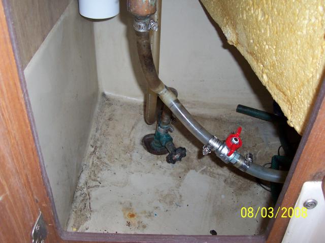

My '83 OD25 has a shut off. It is always open. the design of the boat is such that water only flows out BUT under the right conditions... water could flow in through the valve. I have a picture of it I have added as an attachment.
May 11, 2004
34
Oday 25 Bullocks Cove, Narragansett Bay
A few things I forgot to add...when in the water, water does come up through the valve to the outside water line level which is only a few inches. A leaking valve/hose or through hull will allow water into the boat. The valve coming off the drain line is a drain from the ice box.
To reseat the thru-hull use plenty of sealant. There are forums here that will help you with that.
