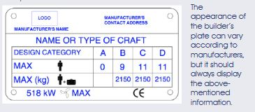

On the CE plates I've seen the difference is usually due to number of people or load aboard, 4 people B, 6 people C, etc.
Ah, now that makes sense. Some of the boats I've been looking at have different cockpit and below-deck configurations that are based on the number of "crew." The ones that are advertised as B/C probably have a CE plate like the one you've shown, with B for a smaller crew and C for a larger crew.
That's good to know. Since we almost always sail with only two on board the boat would be category B.
