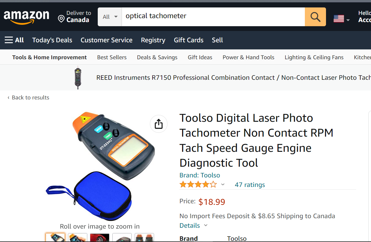

I am seeing a maximum speed of 4.1 knots at 2800 RPM with a Yanmar 2GM.
And how accurate is that 2800 RPM ? Have you calibrated your ship's tach with an optical tach ?
No guarantees when the price is this low but a little research would be in order.
Calculation of hull speed comes out to 6.83 knots which I have been able to achieve on a beam reach in 12 knots of wind.
Even more reason to suspect your tachometer may be the problem :oops: .

Good Points... about "assumptions"...
I bought an inexpensive laser tach to check on our new tach install (part of new engine install) in 2018. Engine panel instrument was spot on, and it's good to know that.
Doing a two-way speed run to check on calibration of the boat's KM is also a great idea on a new-to-you boat.
