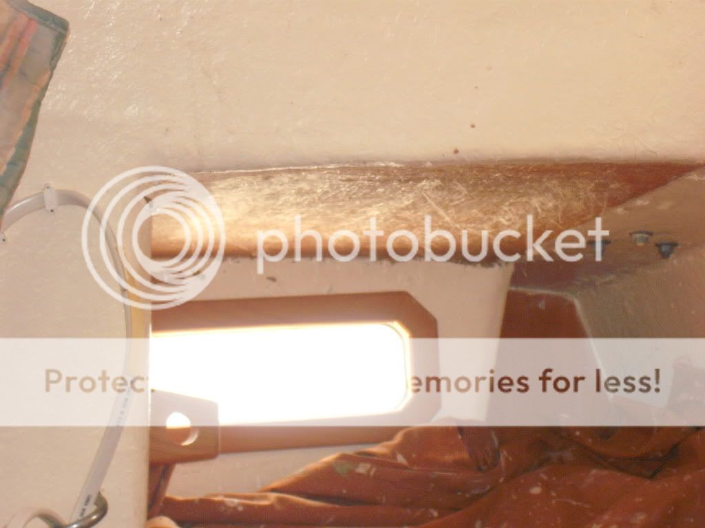

You must remove any paint unless it is of a urethane type so that you can get a good bond. Some long term loads will pull down after years of being secure. For 14 years a rack holding four soup bowls was adhered to this spot. it came down this summer. As you can see it pulled glass fiber from the bond. There are many explanations for this failure that I can discuss if you like.

Thanks Stu, that is exactly what I meant. Anytime people use duct tape they use a lot and cover a large area. For this job to be neat careful consideration has to be given to every aspect of the job and the long term loads anticipated and the possibility of creep. I posted the picture of the minor failure of my soup bowl rack. The contact area was greater than one square foot and the load was less than ten pounds.
