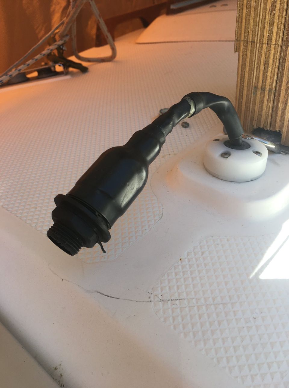

When I first bought my boat it had some pretty sketchy mast connections. It started with an old black plastic SeaCrap (SeaDog) 4 pin connector. My mast lights were not working very well so the first place to start was to take the little plugs parts. Inside I found lots of corrosion so I decided to buy a new "Chrome" SeaCrap connector thinking it would be an upgrade. I have to back up a bit a say that we mostly sail in saltwater off the coast of California. I refitted the new plug and got all the mast lights working again, for awhile. When the lights started going out again I opened up the plugs only to find more corrosion and a wire that had worked itself almost loose from it's microscopic terminal . Here's the part were I'm going to bad mouth SeaDog. The design on their deck connectors is so bad I can't believe they sell them! The tiny Microscopic terminal has the worlds smallest screw in the world to hold the wire in place. Then you have to try and slip 4 wires into a hole in the top that all most impossible to achieve . Once you get the cap down there is another tiny screw you have to line up PERFECTLY into the side of the cap to put it together. If thats off then it shorts out. Sorry I'm done.
Fast forward to finding a better deck plug.

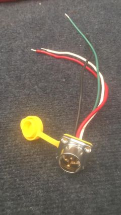

I found a pretty good one and had it in service for awhile but when I tried to buy a spare the company quit selling them so my search coneniud . I final found a company called CNLinko in Florida. I bought some Male/female plugs and wired them up and so far they have worked great ! My mistake though, Was not realizing they made a flush deck plug connector. So I have just rebuilt my deck plug connector again and I'm very happy with it.

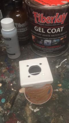

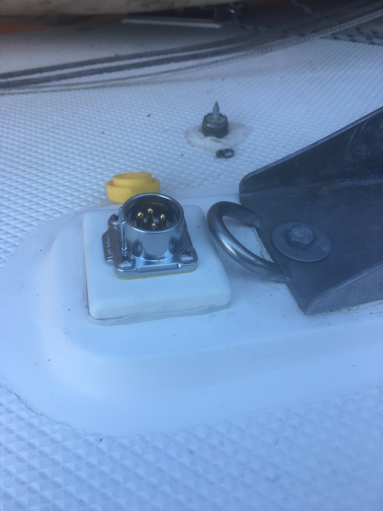

Finally stopped raining so I could uncover the boat and take a photo of the new flush mounted CNLinko deck plug. Super happy with how clean and simple it is. I had to fabricate the white gelcoat riser to cover the hole and old holes from the original plug.
I'm waiting on the female clip connector so I can change out the plug on the mast.

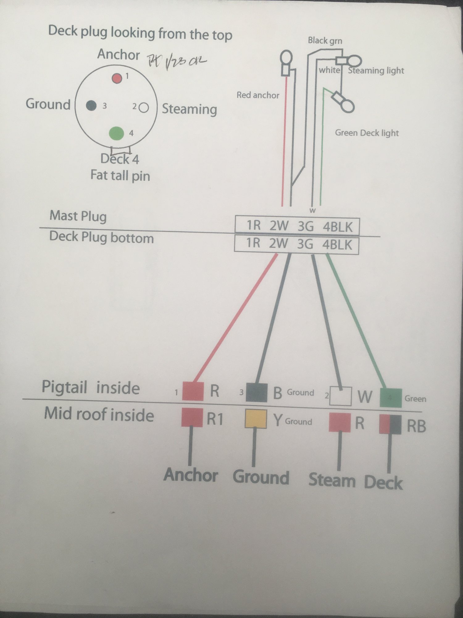

I thought this might help somebody. It's a wiring diagram that includes the mast lights to where the wires come out the bottom of the mast and to the connector.Then from the deck connector through the cabin top to the inside wiring. Everything is color coded. Wiring color changes when it go's to the inside roof of the cabin.
