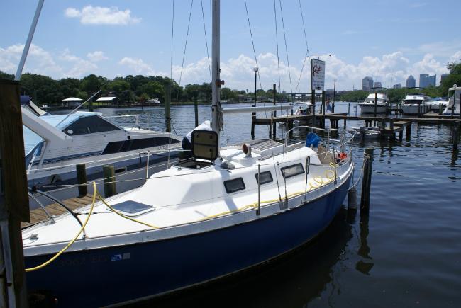

I have a 26' Seafarer sloop that has two sidestays aport and two astarboard. the ones to the top of the mast are properly tensioned, but the two that lead to mid-mast are pretty slack. is this normal? or should I tighten these as well? I am simply not familiar with this sort of rigging. any help would be nice.
