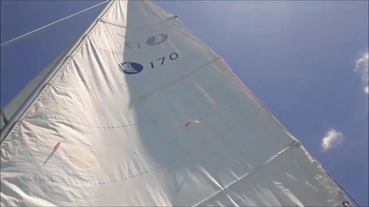

And... if you have a picture of your mainsail taken looking up from the boom to the top, I'd be happy to analyse the shape. Please follow the instructions at
How to Photograph Sail Shape for how to take pictures.
You have to be sailing close hauled in 10-15 knots of breeze, with the camera looking straight up from mid boom to the head for the analysis to be valid.
It will be very interesting to compare the shape of the sail to the number of days used, by fabric type.

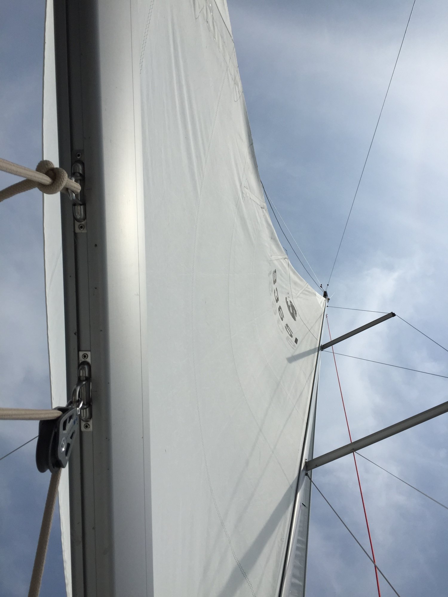

Here's what a new mainsail looks like:

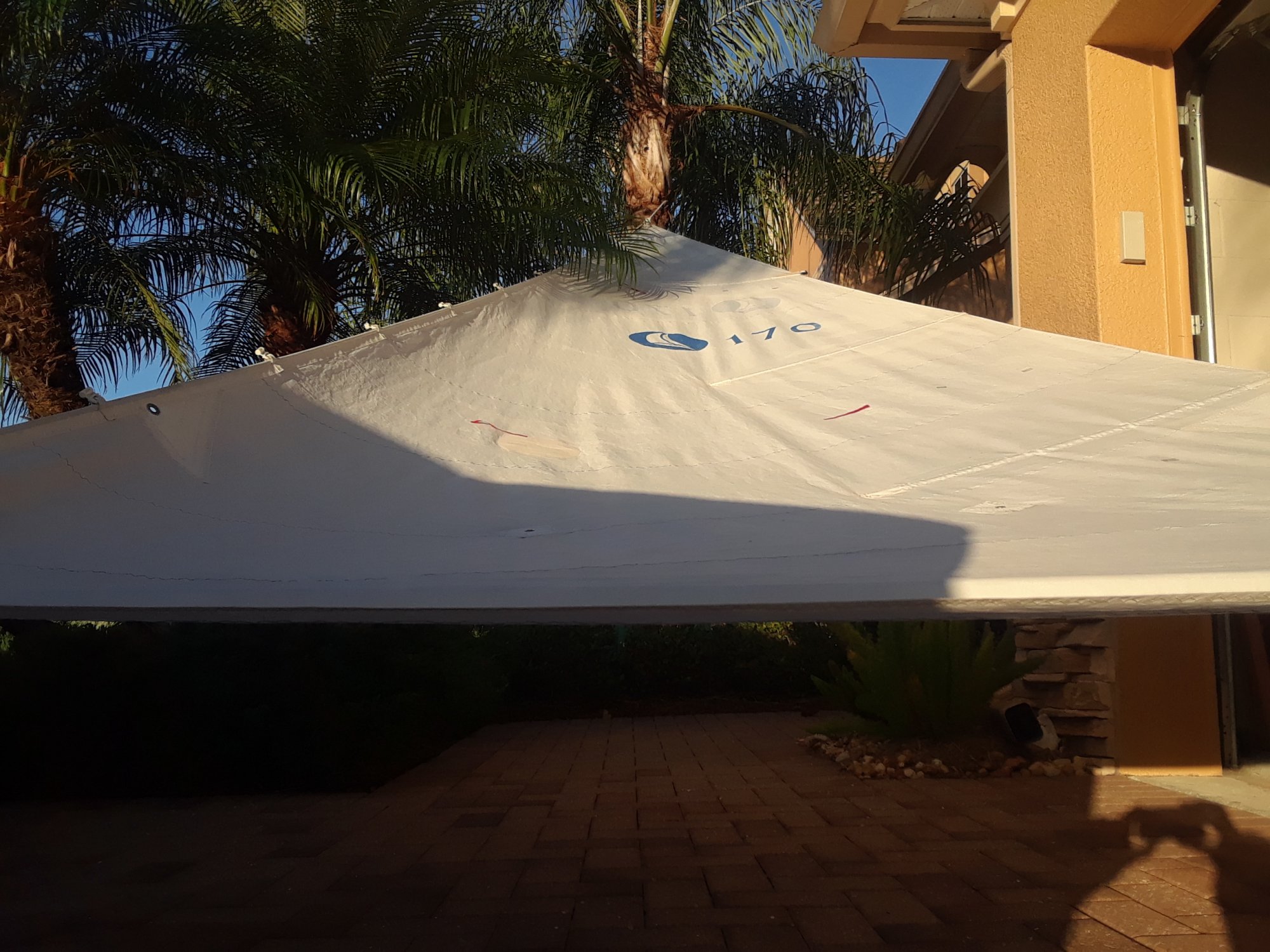

And here I just removed my mainsail for the next couple of winter months. I'll get back to this in the new year.:biggrin:

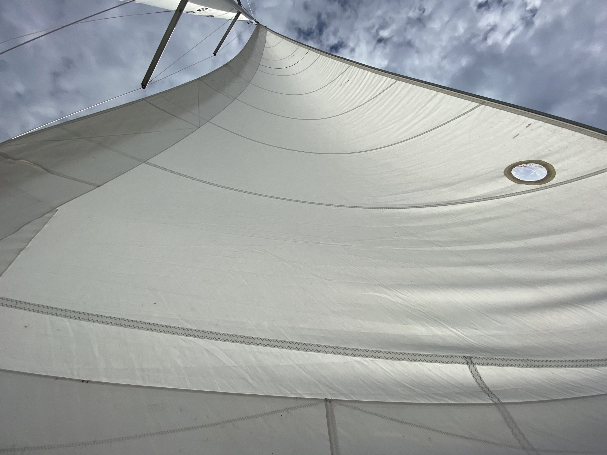

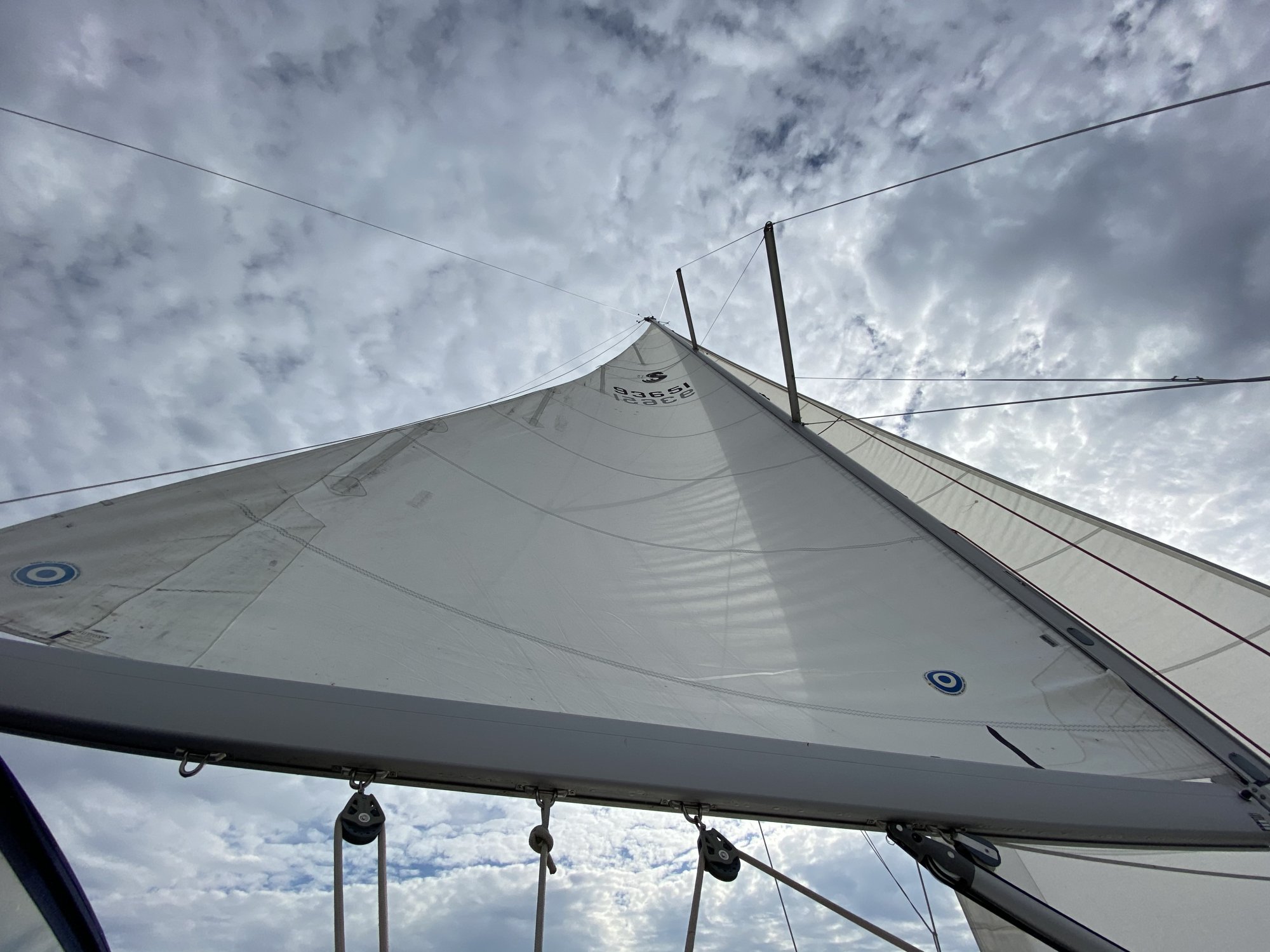

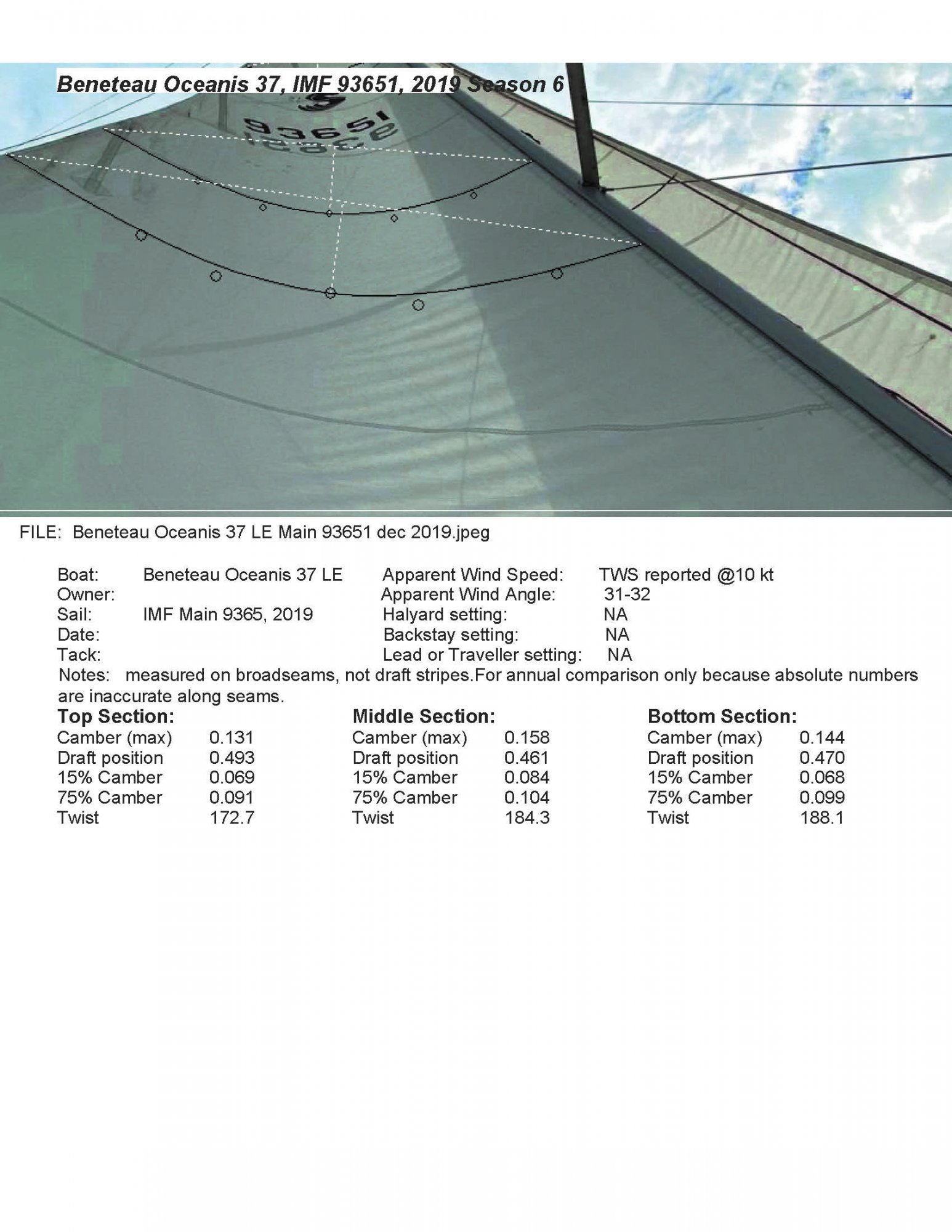

Here’s one I took toward the end of the season, upwind in about 10 kts true -

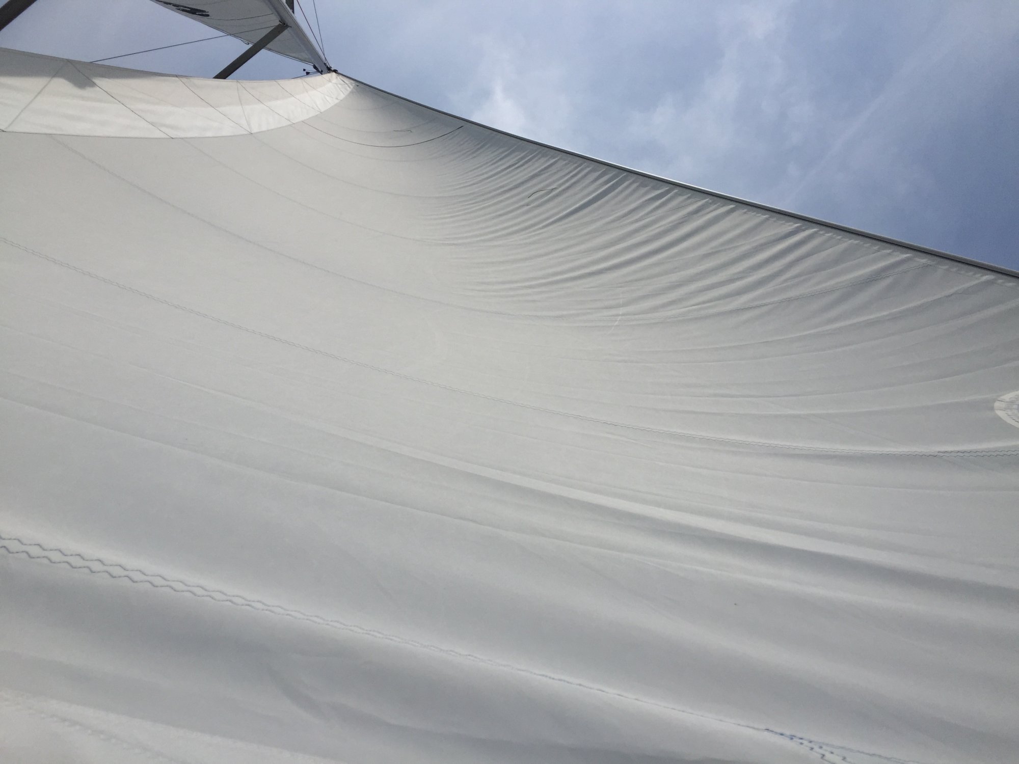

And one of the jib -
For comparison, here they are in similar conditions in early 2015, so 1 season vs 6:
Any insight appreciated :)
We haven’t had any significant work done on the shape, but have had some re-stitching to the batten pockets and small stuff like that.

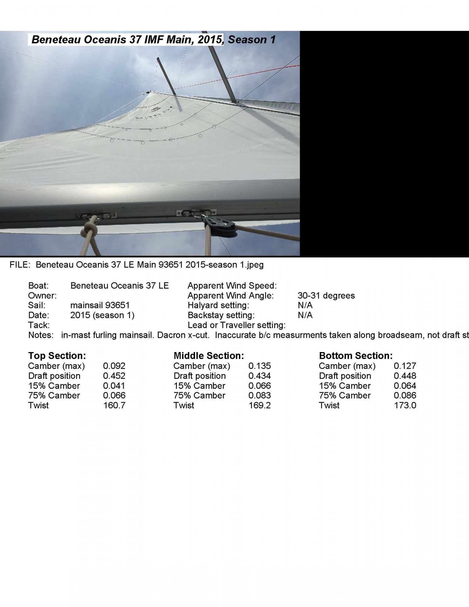

Thanks to @Davidasailor26 , here's a nice comparison of Season 1 vs Season 6, with an estimated 150 use days @ 8 hours each = 1200 hours. That's a lot of hours for a dacon cross cut sail.
The Beneteau sails from Neil Pryde sails are a decent grade of OEM dacon. Nothing fancy, but not a decent grade of cloth and decently construction. Better than some OEM sails I've seen.
This is an in mast furling mainsail, without draft stripes (or points for slab reefing), so the only curves I could measure were along the seams, which are not horizontal to the foot. So the absolute numbers aren't accurate in terms of draft due to distortion. Number for both depth of draft and draft position should be slightly lower than what the software reports.
Nevertheless, it's instructive to note that both the depth of the max draft (camber) has increased by several percent and the position of max draft has moved aft by several percentage points as well. Visual comparison of the arcs indicate that the leech section of the sail has too much draft as well. It should be flatter in the leech section.
Overall impression:
To my eye, the mainsail shape is a little baggy and past its prime in terms of shape. While it's still servicable, the boat would handle noticeably better (point higher, handle gusts better and reef later) with a new mainsail, IMO
Note 1: Furling mainsails have an increased tendency to jam due to folds when they get baggy, so keep an eye on it in terms of furling.
Note: I didn't compare the headsails, because the forestay is sagging noticably in the 2019 picture vs 2015. That would make the draft deeper, so it wouldn't be a meaningful comparison.
Thanks very much! I did just go back through my logs and reevaluated the hours actually under sail, versus motoring to and from sailing areas. My estimate now is a total of about 900 or 950 hours with the sails unfurled, so a little less than the original 1200.
Overall impression:
That pretty much matches my observations. It seems like our pointing has declined just a little compared to other boats we sail with. Nothing too extreme, just a little lower relative to some of them.
Going to be on the lookout for that. We've had occasional jams un-furling but usually only if we're not careful to tail the in-haul. Nothing yet that seems like the bagginess is getting in the way, but I know that won't last forever.
Yeah, the mast was re-tuned in late 2018, easing the backstays which added sag to the forestay. Noticed it this summer. Took the sail down for winter a couple weeks ago and measured the luff hollow as about 9", well less than the amount of say we get in 10-12 knots. Need to have some re-stitching done over the winter so I'm going to ask the loft their thoughts on the target amount of sag.

I think folding my sails hurts more than sailing them. They have been repaired at the batten ends already.
I cheated and hung my main from tree in front yard. Does this count. Ill try to hoist sail tomorrow. I noticed the leading edge curls in more other pictures posted. This might be why i always have a luff bubble, when not reefed.
I do have some action shots of sloppy trimmed sails
