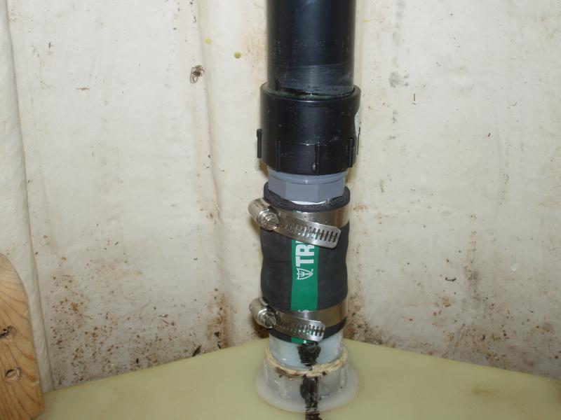

Been using ABS for over 8 years. PVC isn't good enough. See picture.
A short Trident hose for flexing, ABS up to the top and Trident hose for the pump out.

The 90 deg elbows will get you every time in that application. I'd suggest you do anything BUT create a routing which requires multiple sharp turns.

Excellent replies! My goal with the ABS is to not use flex hose where sewage will stand in it.
I hate putting in the 90 degree elbows but can't see a way around at least one in the pump out. I assume there are large radius "sweep elbows" that would be more free flowing than the standard 90's.
There are, and you can find 'em in the plumbing section of any of the "big box" hardware store. Connect the radius to a threaded tank fitting...ABS pipe to the top of the tank...hose to the deck pumpout fitting.
