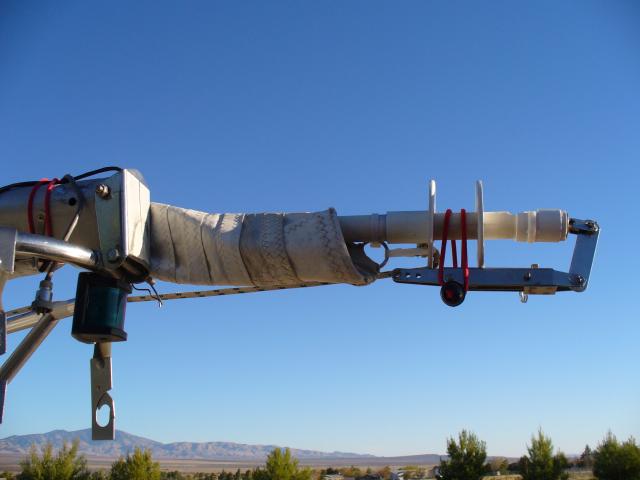

Like Caguy siad, I love mine and in answer to your removal question: I only have to pull one pin at the Johnson lever to remove it and the furler sail and all will slide off. Screw the Johnson lever back in , add the pin, re-attach to the bow and hang your jib. Don't know why you would want to do this as you can just roll in the genoa to get the desired power if the winds get to crazy.

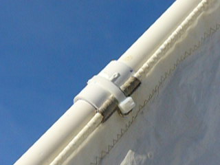

I used large zip-ties to attach the sail but caguy and I are looking at other ways to attach to sail to the furler.

I see you finally broke down and shelled out for some large 1/2'' zip ties. There is no problem with the inner zip ties as they are coverd by the sail when it is rolled up. The problems I found were on the end ties where the sun hits them. I eliminated this with several wraps of 1/8'' cord. Has lasted a couple of years and I have not heard from new owner regarding any problems.
In regard to tearing down. I disconnect the forestay above the Johnson leaver, after securing mast with the mast lowering system. I remove the split cap and slide the furler off form the forestay. This allows me to lower the mast without the weight of the of the furler and sail. BTW I tie the furling line to the forestay before removing it from the furler so that I can use it as a mesenger to pull the forestay back through when raising the mast the next time.

Here is a shot of mine partly rolled in as I saw a big gust of wind coming across the lake. It's nice to know that you can reduce sail in a few seconds and then return to full sail minutes later.

The halyard is not used. The top of the jib is attached to the PVC. The luff of the jib is attached to the PVC at each grommet hole on the jib. The length of PVC between each grommet is long enough to keep the luff taught.
