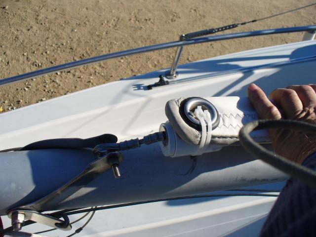

While searching this sight for info on home built pvc furlers, I found caguy's post dated 4/09. I then went out sailing with Frank, watched how his PVC Furler worked and decided to make one of my own.

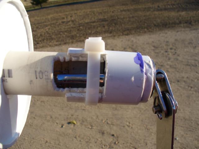

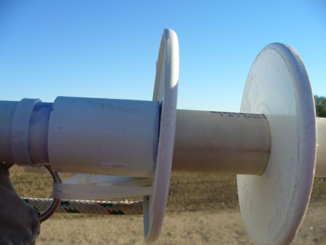

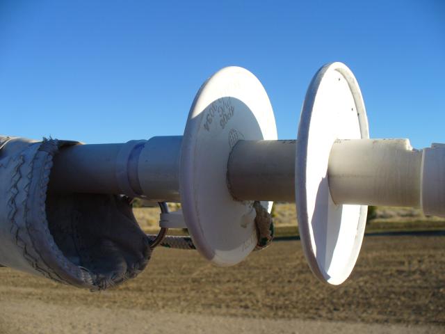

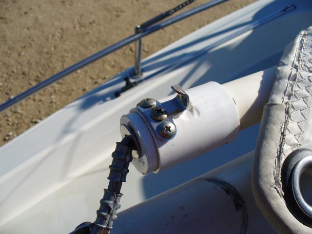

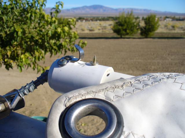

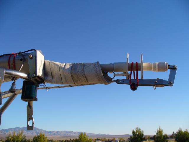

It was very easy and the video shows how well it works. I put groves in the couplers to keep the zip ties in place and used a plug at each end with a hole just big enough for the wire to go through. I used SS washers on the bottom. The spooler is 2 - 4" caps cut down and a hole drilled in the middle just big enough for the 1" pvc pipe to slide through.
It is my belief that this pvc furler will spread out the stress of the Genoa on the forestay. Any input on this subject of stress would be great.
Side note: Now I can use the jib halyard as a down haul for the main and with the quick furling of the genoa makes it easy/safer for me to solo.
