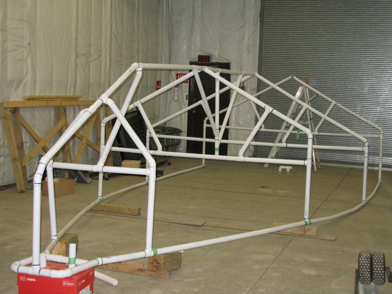

Here is a picture of the PVC tubing frame that I built for my 33. (hopefully it uploads correctly) The frame sits on the rub rail and is supported at the stanchions. The middle section sits on the mast step. The pieces are glued for the most part and screws hold the sections together when it is assembled. It disassembles into pieces no longer than about 6 feet.
Hope it helps.

nice job Jake- looks like you padded up in the bow to allow for the deck's contours too.
What is that, 2" or 1-1/2 ID pipe?? I suppose you use canvas cover. I found out tha hard way 30 yrs ago that the blue tarp on these frames just gets brittle in the cold and shreds in the wind.

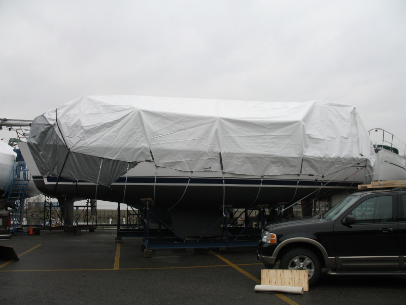

Thanks. It is 2" vacuum tubing so I think the outside diameter is 2". It fits like a glove and has worked well since 2006.
I have a fitted rip-stop tarp as the cover. It is the same material that is used on temporary car ports in the winter. It's like a tarp material but quite a bit thicker.

The only pictures I have are from the first year and the cover was not made to my specifications. It has since been adjusted and it fits better now but not as well as I had intended it to fit.

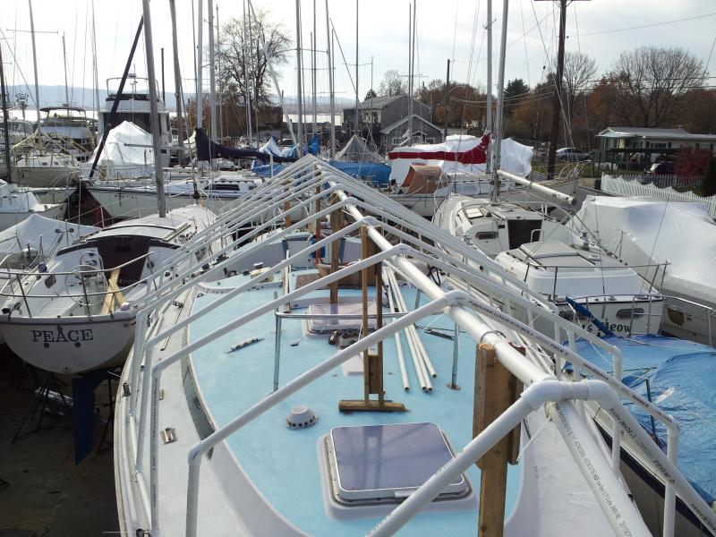

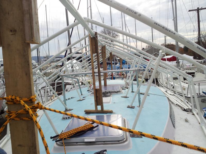

Jake, I think it was on this site. I saw it also and I am building my first one.....Past years I used 5/4" spruce. This is all un glued, mast is down so its easier. I can break it at the ridge if I want to reuse....not sure yet....Red
