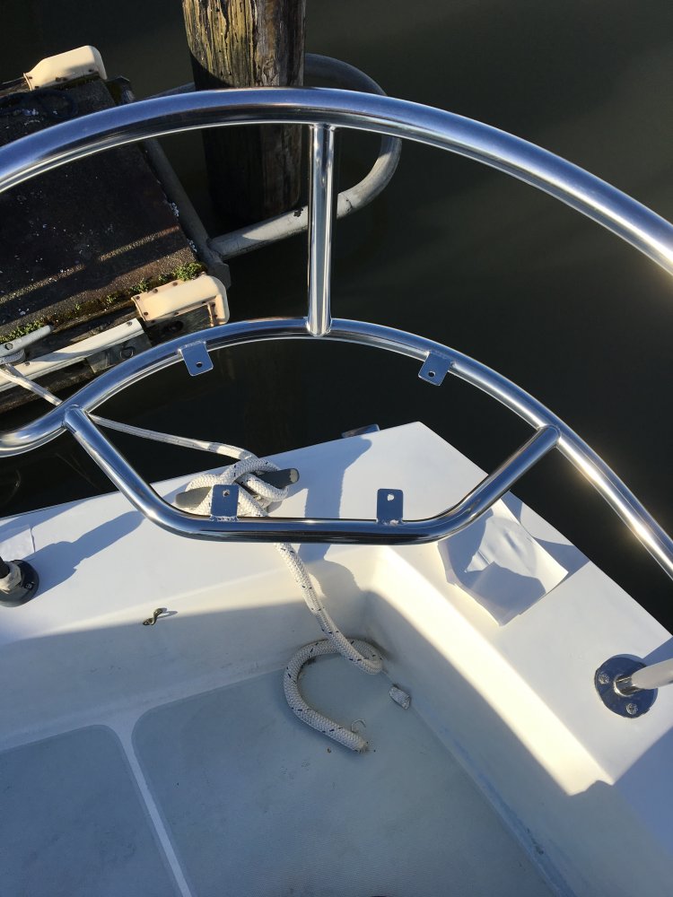

Is the same pulpit used on a standard rig as on a tall rig?

Thanks Ted. That pulpit looks like the offering from Catalina Direct. Even the description looks the same.
Looking at the photos on that site and photos of my boats rail, the length in front of the forward vertical rail looks about half of the length on my boat. The cad drawings do not show that measurement.
I'll keep that site bookmarked.

@Calif. Ted , @jssailem , @Joe Thanks for the help.
CD, Ted's link, Joe's link and photos of the pulpit rpell1 has for sale all look the same. Joe's link is the most telling because it calls out the difference for the bow sprit option as the removal of the lower rail but the upper rail does not extend beyond the bow sprit.
I'm asking because my pulpit extends several inches past the bow sprit. The length of the rail from the forward vertical support to the bow light mount appears to be more than double length than the pulpit in all the photos and links posted.
If that is the only pulpit made for the C30, I guess my next question would be this: Is it better to have the bow pulpit protect the bow sprit or the bow sprit protect the bow pulpit?
Here's the back story.
When I bought the C30 I knew the front rail had a little droop in it. Looked like someone too heavy sat on it. Didn't bother me.
Thursday I was practicing going into my slip and I got a bullseye on a piling. More droop and a shift to the port with a kink.
The aft attachment plates both have 1/3 of the plate bent up a little and pulled a machine screw out of the embedded backing plate. No fiberglass damage and I can always drill and tap a new hole.
I can live with it for now and wouldn't want to replace it now anyway until I get more experience docking.
rpell1 has a pulpit for sale and I am trying to decide to either buy it despite it being shorter or wait to off season and have someone try to repair my current one.

Ward, I suspect you cannot build a pulpit strong enough to protect your bowsprit. Your going to have to accommodate the sprit in how you maneuver the boat. They way they are made, attached to the deck and extended into the space beyond the deck, they are mostly ornamental. They do provide some aide in they are something to grab, but placing all your weight on a pulpit while loosing your footing on the deck as the boat is bucking in 6 foot seas does not give me a warm fuzzy feeling. The pulpit will try but eventually lose the struggle.

After Hurricane Katrina, I ordered a new bow pulpit from Railmakers (Catalina OE supplier) for my 1986 C30TR. Their part number was 29044 for about $410 + $200 shipping to Gulf Coast (2005 prices). I think your Mk II would use the same pulpit but not sure. You can give them a call at 949.642.8506...good people to work with. They even fabricated a custom stern pulpit for me with seats.

Today I had a chance to look at a 89 C30 TR w/Sprit. The top rail is about 6" shorter than the rail on mine. It looks like most were made that way so maybe mine was custom?
So, I contacted rpell1 and bought the pulpit he salvaged from his dropped boat.
