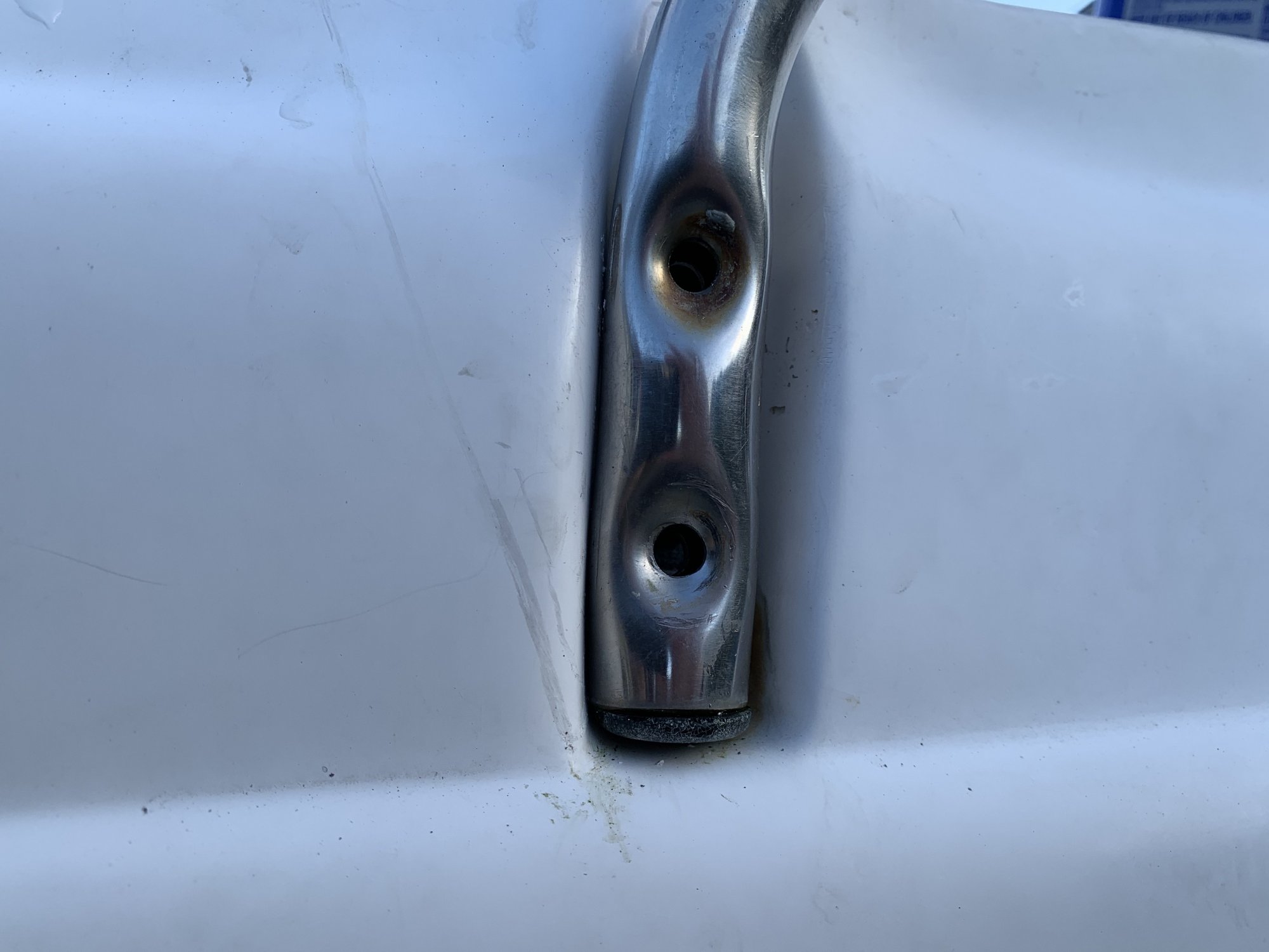

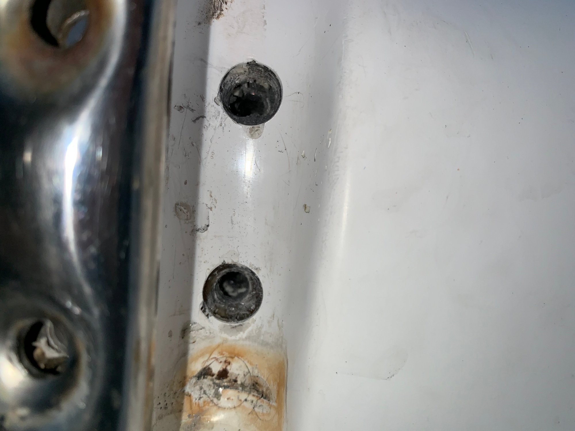

Today we pumped 6 gallons of water out of the front area below the water tank of our Hunter 260. There seems to be two points we've identified for leaks. We fixed the first one, by cleaning up the hole and filling it with butyl. The second one is at a pulpit base. When we remove the screws and looked into the screw hole it was obvious that the PO had had a similar issue and attempted to fix it with some sort of silicone. I spent a bit of time removing the silicone and attempted to fix it with butyl. It didn't seem to work. There is a lot of gap between the pulpit and the boat.
The screw is much smaller than the opening, and it seems to be an open void. I think the PO tried to fill the void (which is between the hull and the liner) with silicone.
Looking for suggestions.
Thanks,
Sean

Drill out that hole a tiny bit bigger so you remove any trace of silicone that’s in there. Fill the hole with thickened epoxy, let it cure, drill the proper size hole that you need. When you drill the proper hole, try to bevel the edges so it’s less prone to cracking and the Butyl has a slight recess to form a seal.
That should do the trick. I had a similar problem with my chainplates on my O’Day. After that process it hasn’t leaked since.

Spoke with the owner. One bolt thread is stripped suggesting to go bolt one size larger tapping the thread for it. Advised 4200 or silicon to seal. Butyl tape does not work well here.
