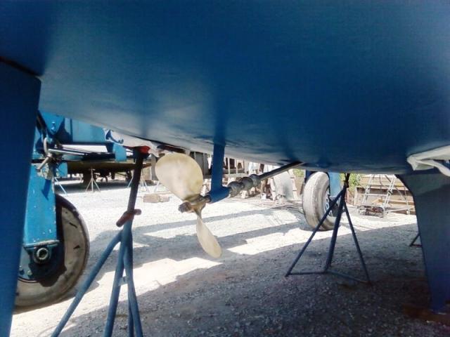

Hey, Gordon, My prop threw a blade and the unbalance broke the strut. Pulling the strut mounting plate was not bad at all. There were 4 thru-bolts and it was bedded in some kind of hard, like epoxy, bedding compound. There was 5200 around the mounting bolts. There are probably shims under the mounting plate to make it line up with the engine coupling, so be careful to put them back EXACTLY like they came out. In the attached shot, you can see the rectangular mounting plate where it is recessed into the hull. We re-shimmed and re-bedded with West System and a little 5200 on the bolts again.. Not a big job but re-aligning the skeg was tedious and then the engine had to be re-aligned too.. If you are lucky, you may be able to get the plate off without disturbing the bedding and shims, but I wouldn’t bet on that.. Fred probably has some better pictures of the skeg.. Rich's idea of just moving it a bit up is pretty slick too..
