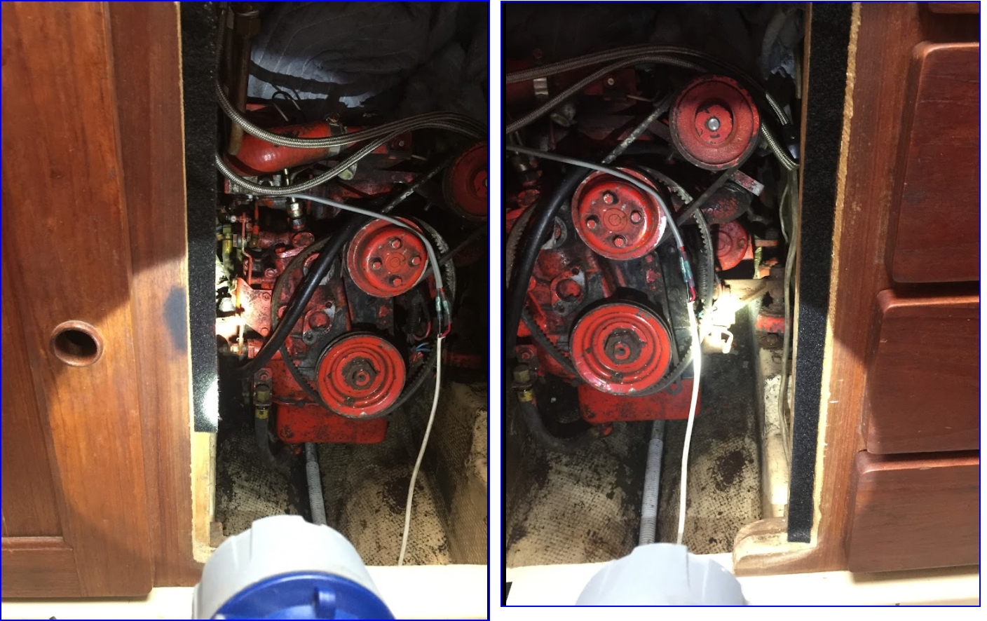

Hello,
I have an dead Westerbeke 13a which I'm determined to get out of the boat this winter. I was hoping to just slide it forward and lift it out, but the opening in the cabinetry is 14.25" wide and the motor with the mounts are wider than that by what looks like about 2" on each side.
3 of the 4 front mount lag bolts I could pull, but one seems to have the head rusted to the point where my socket just "slips" and it's behind the mount so I can't see it. Access to the back of the motor is a nightmare also, so getting those mounts dealt with and the shaft coupler are going to be a total PITA.
If I can get the mounts free from the stringers, sliding and trying to twist the the motor mounts around the opening may still work. But if that does not, what do you think the odds are that I could cut through the mounts that are bolted to the motor itself and use a few 2x4's under the oil pan to slide the motor forward? Would a hack saw or some power tool work for that? See arrows in photos. If cutting those is not practical, would cutting the vertical bolt between the mount base and the part my arrows point at be better?
Any suggestions are welcome.
Cabin cabinet opening 14.25" wide.
Mounts on stringers.
Dimensions from the motor info.

Fortunately, it’s a relatively light weight engine. I had the same problem years ago with a 5411 Universal. Cut the mounts with a disk and lifted out companionway using the boom and some tackle. The fun part is getting it to the ground.

Cutting tools that come to mind are disk/grinder, sawzall, multi tool, plasma cutter.
What about putting a flat basket ball under the engine and then partially inflating it. Cut the mounts. Then pull the engine forward.

Don't cut the parts your arrows point to. Are you planning to rebuild the motor? Can't you remove the nuts that hold the motor to the motor mounts, lift the engine to clear then pull it out? Once out you'll have lots of room to work on removing the mounts from the stringers. If your shaft is old and corroded it might be easier to cut the shaft than to deal with the coupling. You will want to check the shaft for straightness and the condition of it and the cutlass bearing as part of your project. New shafts aren't real expensive in the scope of a project of this scale.

Once freed your 2x4 slide idea will work nicely. You can raise/support your engine easily while disconnecting the mounts with an auto scissors jack under the oil pan. Halyard deflected outward with block on boom will raise engine using your winch. Someone may want your old engine so you probably should not damage it while removing it. Be careful.

The old motor is not going to be rebuilt. It died I expect about 2006 when a new Honda 9.9 was put on the back, which is how I purchased the boat. I expect the removal hassles are why it's still there. The fuel tank, plumbing, and controls are all removed at this point.
Once the motor is out, and it's getting bottom paint again, the shaft and strut will be removed, glassed over to simplify the bottom. The stuffing box will be left in case someone wants to convert to electric or something in the future.
The scissor lift or the basketball (which might roll to help move it forward are both great ideas, thanks.
I will soak the very rusty bolts holding the mounts to the motor, but don't expect much. That said I have weeks and months of time for this before sailing starts in the Spring.

If you are able to get the motor free of the mounts, will the motor go through the space?
If so then just cut the bolts of the motor mount. Or cut the rusted nuts and lift the motor off the mounts.

The biggest issue is that the mounts extend the width of the motor past the opening by several inches. Whether I get the bolts out or need to cut or unbolt the motor from the mounts, I may still need to remove the mounts from the engine block to get it narrow enough. That may end up being a hack or sawzall type project.

Those mounts are bolted on, Cant you just remove them instead of cutting them? At the worst cut the bolt heads to get them off if the bolts are seized.

Possible but access is a bitch and they are rusted badly. I have them soaking in spray on lube so maybe I will have some luck. I may only need one of the two front ones off since I can then maybe rotate the block to get it past eh fixed cabinet opening.

Which ever path you take cutting, grinding, etc. caution regarding heat. The area looks to have combustibles that would not play nice if they got too warm.

As to the OP's question - if you're just dumping that engine, I'd cut those mounts with a sawzall. Get a few good metal cutting blades, fairly fine toothed, and they will make short work of those mounts. Easy.

Get a welding blanket from your local auto parts store or McMaster-Carr and cut it up as necessary to protect the flammable bits, then grab your 4" angle grinder and cut through those bolt heads, only a couple minutes each.
Try a wafer disk and a grinding disk, wafers cut faster and make a lot less mess but grinding disks don't require much finesse.
