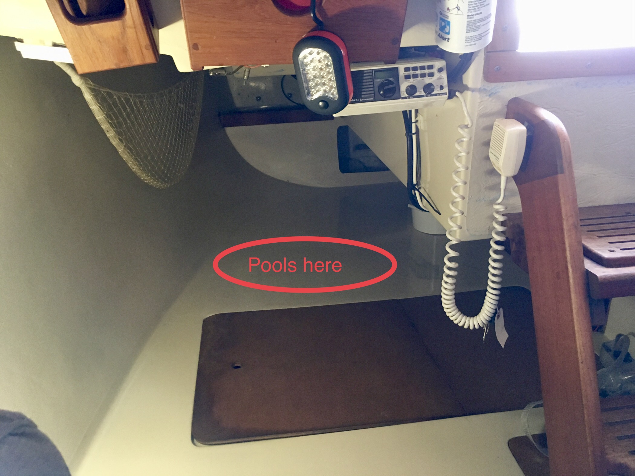

This is our first Northern California winter with our 1987 C25 WK so I wasn’t sure what to expect in possible leaks. Through plenty of storms, she has stayed dry from bow to companionway inside. But a small puddle of water (couple of ounces) that pools in the aft quarter berth is driving me nuts. I can find no leaks on any hull fittings, chainplates, winches etc. I’ve spread chalk inside the hull and it stays bone dry. I’ve caulked the scuppers. Checked the dumpster (port locker) and it is dry. After the last storm I noticed the underside bottom of the cockpit, inside the boat, had a thin coating of water, kinda like you’d see on the inside of a single-pane house window. Is it possible my few ounces of water could be dripping from condensation? Has anyone had a similar issue? Many thanks in advance.

fir such a small amount, absolutely. is it in tye morning or evening you notice?
on my c25, it was alarming how much condensation i had after sleeping aboard. the windows and hull were dripping.

No particular time, that I can pinpoint. Just there when I check the boat after a good rain.

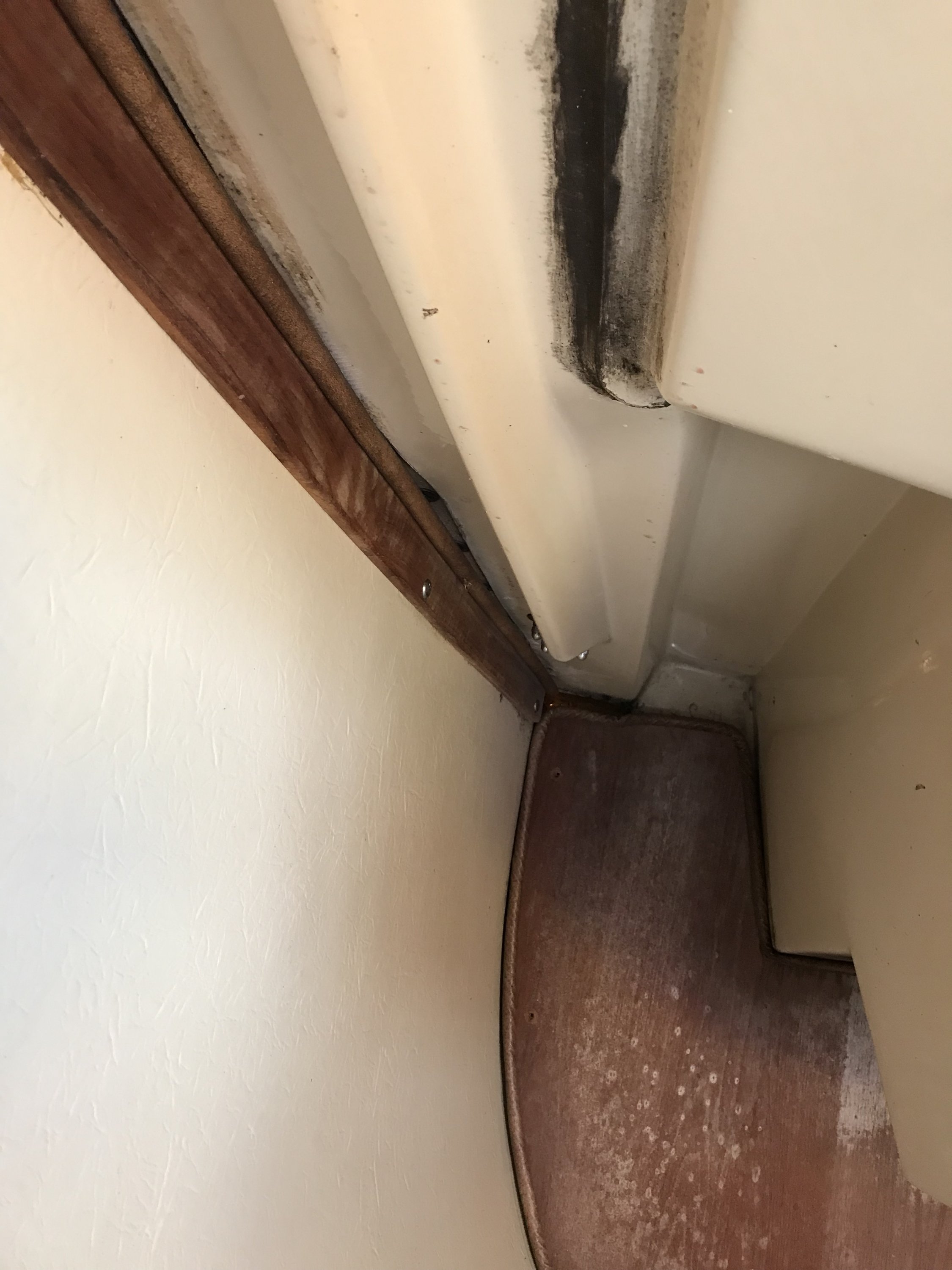

My 1980 Catalina 30 also makes such puddles. There's a ridge of fiberglass with is probably structural as well as a wire chase, running the length of the boat. I found an unintentional hole in the side of that channel, out of sight. There is also water from under the panel nearest the transom, and both seep very dark brown water that quickly dries, leaving dark brown sediment, which happily is easy to clean up. I'm thinking is some dark brown caulk, but I too have not yet found the leak. Hope someone has suggestions for us both.

Interesting. Is the ridge along upper side of the hull?
