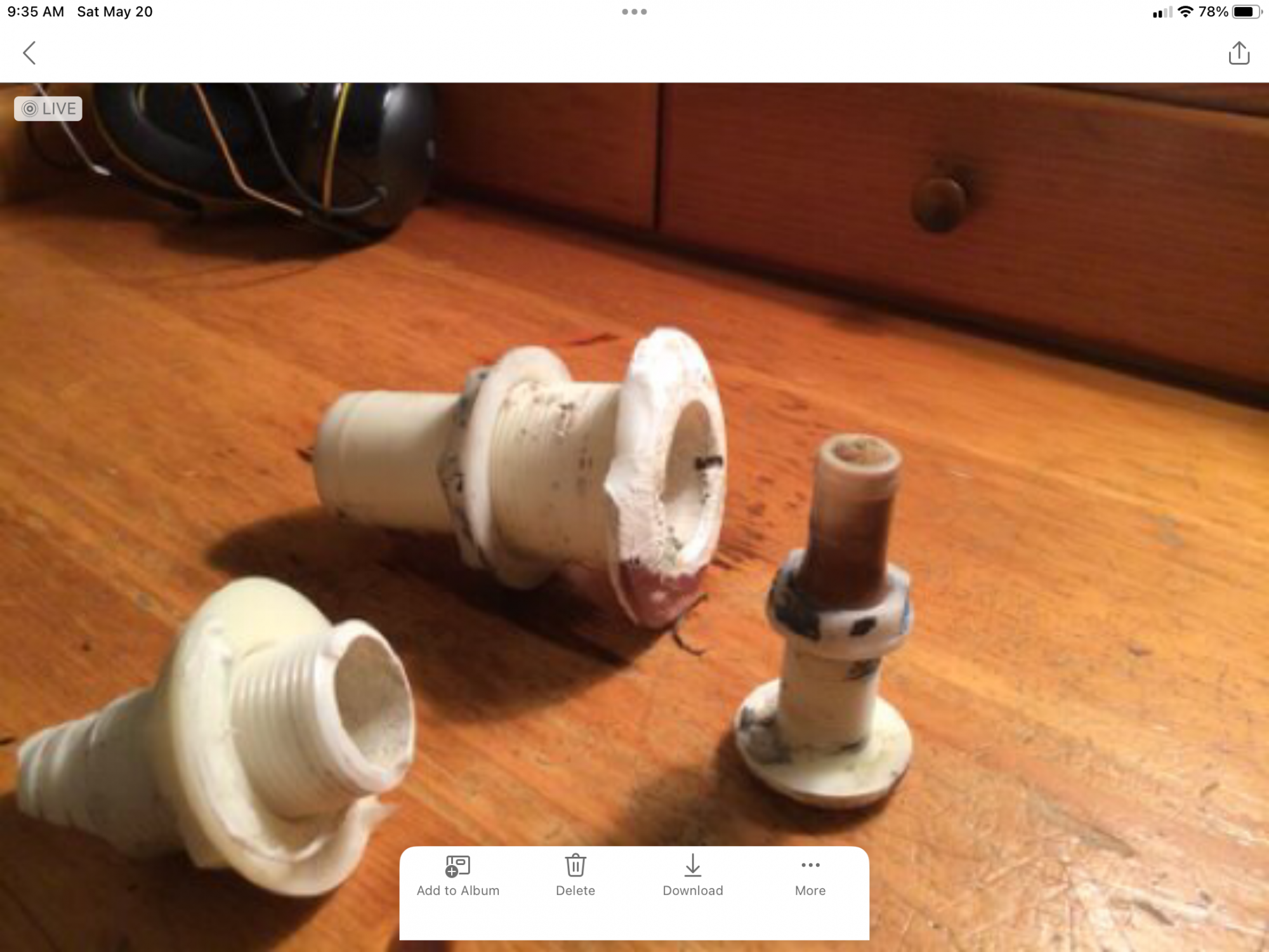

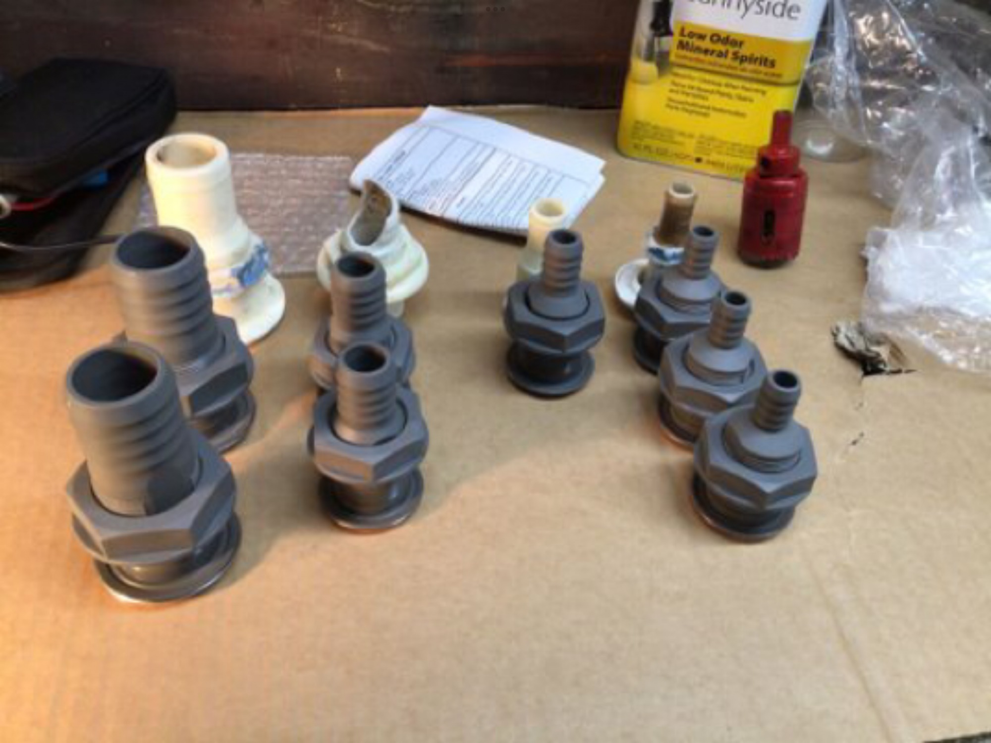

I had 8 original nylon drains (can’t really call them thru hulls). They were all right above the water line. I could remove the hose and not flood the boat if I was sitting in the slip, but many (particularly the 4 in the stern) when the rear squats under power, or the ones on the sides when healed over…
One caveat to all who replace this sort of fitting…the hole sizes have changed for some sizes, for the same hose bard size…
I had to drill larger holes for some sizes, and I had 2 that I thought I might need to epoxy over the hole and redrill to make it smaller :facepalm:. I ended up not doing that, and they seem fine, but it was close.
