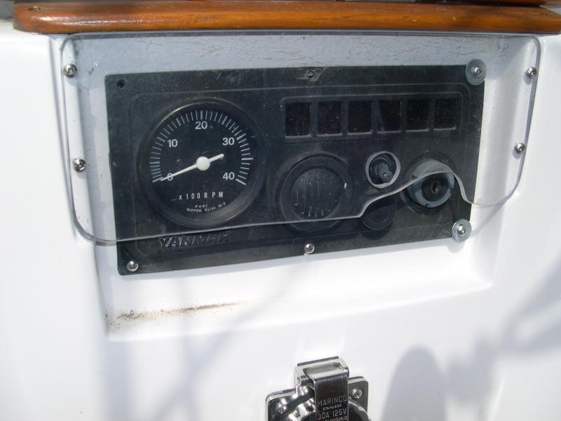

key protection ( Hunter 37C )
This is an old picture, I have since replaced the front face of my Yanmar panel, but you can clearly see the plexiglass cover installed over it. It provides a cutout for the key and switch. This provides water protection as well.

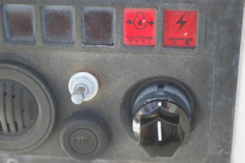

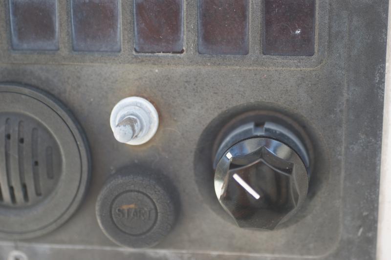

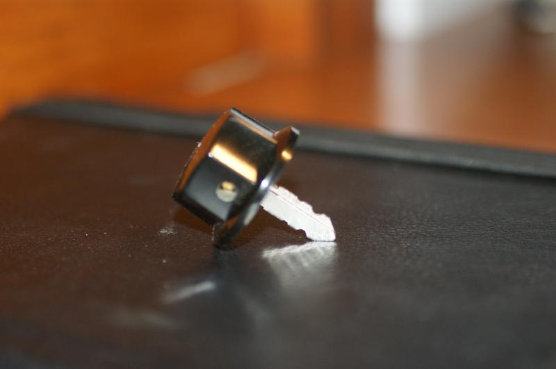

I had the starboard jibsheet break the collar holding the switch (key was fine, but provided the handle for the sheet to pull on) so I had to replace the switch. I used something like the MaxPower universal small engine switch ($10) from Autozone. Works fine with the existing hole and came with 4 keys. I have not thought on what to do about protecting it, but have thought of cutting the head of the key off and inserting it into a smooth nob that is unlikely to get caught on something like a sheet or the admiral's sandals or body parts. http://www.radioshack.com/product/index.jsp?productId=2103791 or http://www.radioshack.com/product/i...02829&filterName=Brand&filterValue=RadioShack
I did this for my motorcycle gas filler access hatch (keyed). This always stays in place (not worried about people stealing my gas) and doesn't get caught on clothing or gear.
Finally got a picture or 3 of the key mod. See attached.
