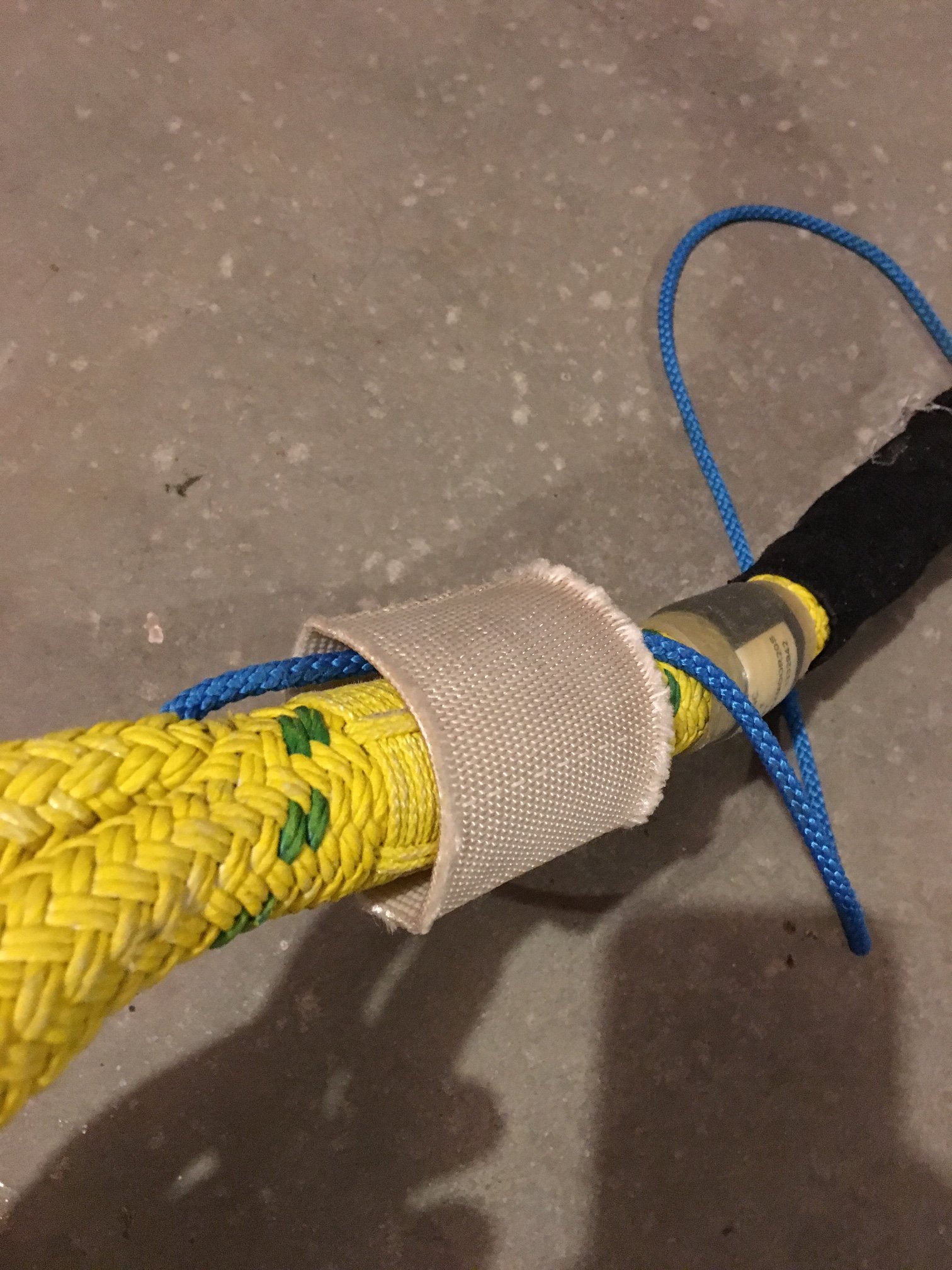

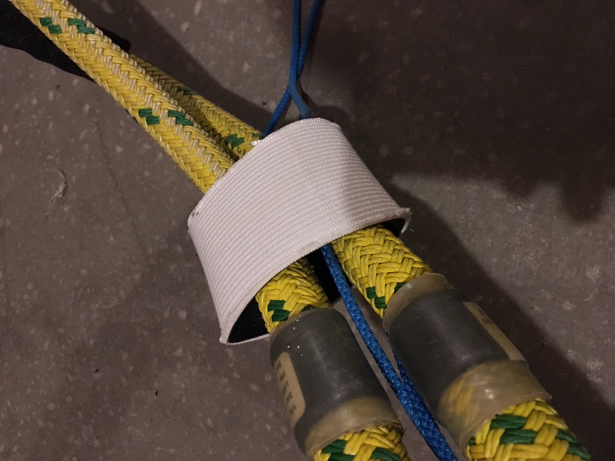

Hello,
My cape dory 27 is on a mooring (north shore of massachusetts).
For my pennants, I presently have followed MaineSail's method of 2 Yale Maximoors lashed with toggle buoys along the way. Unfortunately I have found that one or both of the pennants wrap on occasion, which I believe is due to the fact that the mooring ball is a top ball chain connection, not an under-ball connection. As this is a rental mooring, I cannot change the configuration and I also dont know if there is a swivel in the chain setup
Last summer, an instance of chain wrap damaged one of my pennants, so this year I am looking for a solution to protect them. I have found surplus canvas firehose in a few different diameters. My proposed solution is to thread the pennants through firehouse, either both through one big hose, or individually through their own smaller hose, then lash the toggle buoys on as usual.
I have included photos below -- should I go with both pennants through the same hose, or thread them individually through their own hose? I am leaning towards both through the same, on the grounds that this would make it unlikely that one pennant would wrap around the mooring chain. Thank you for any help.

... either should I go with both pennants through the same hose, or thread them individually through their own hose?....
Since you are betting the boat on what you do, why not do it both ways, if you can?
