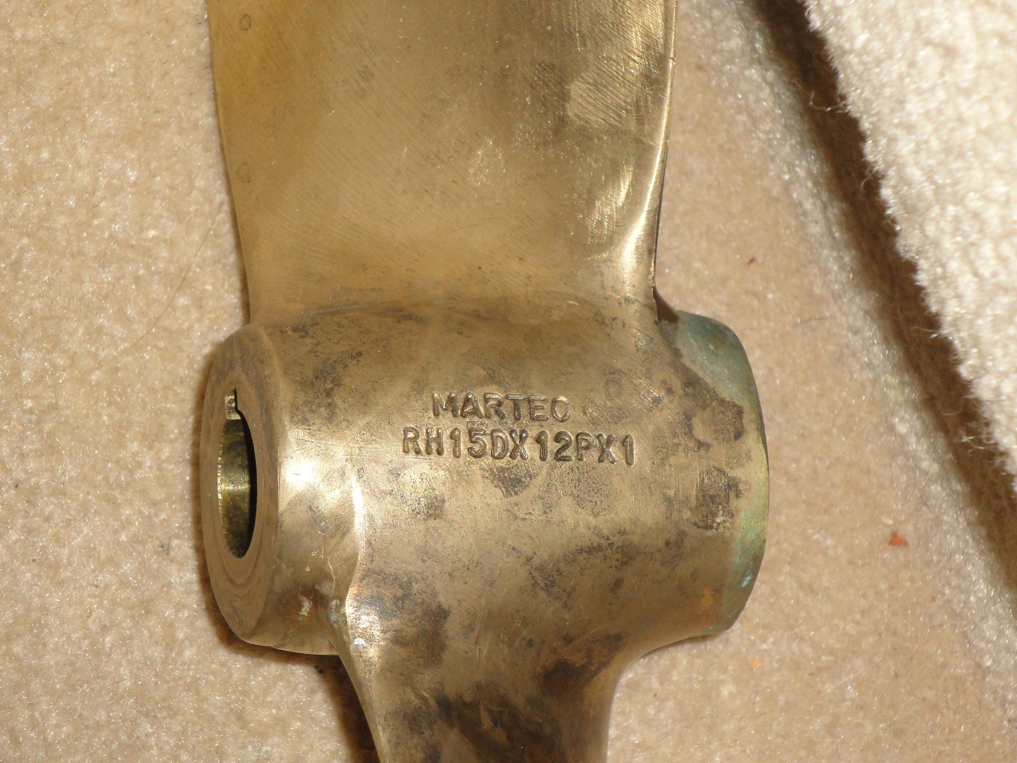

Went from a 15 X 12 two bladed prop
to a 14 X 10 three bladed prop.
The first time we were out I thought I had lost the prop it was so smooth (compared to the two bladed prop) I thought it'd fallen off. The manufacturer called me up after a few weeks to check on the performance and after a grilling, they wanted to increase the pitch to 11". The engine now had to do a bit of work to get to 3600 RPM with very minor smoke.
As for speed, not really any change (still 5.5 knots) as I think the previous prop was just as well matched to the hull and motor.
