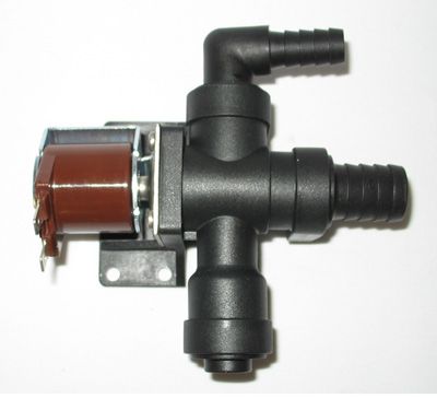

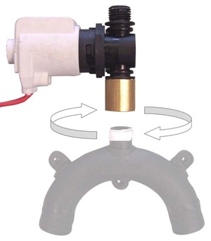

Vented loops are siphon breakers...they have nothing in common with tanks vents. You're also confusing discharge vented loops with flush water intake vented loops.. and yes, sea water electric toilets do need an intake vented loop unless your toilet is above waterline, which is unlikely on your boat.
Where to put it depends on the make/model of your toilet...if it's a 37010, it belongs in the line that connects the pump to the back of the bowl, same as it should be on a manual toilet. If it's one of the all china thrones that doesn't have line connecting the pump to the bowl, It has to go in the line between the thru-hull and the pump, but with a solenoid valve wired to the flush button---one of the two types shown in the attached photos---that opens and closes the air valve.
--Peggie
Jabsco 37068-2000 vented loop with solenoid valve.jpgjabsco 37038-12 solenoid valve.jpg
