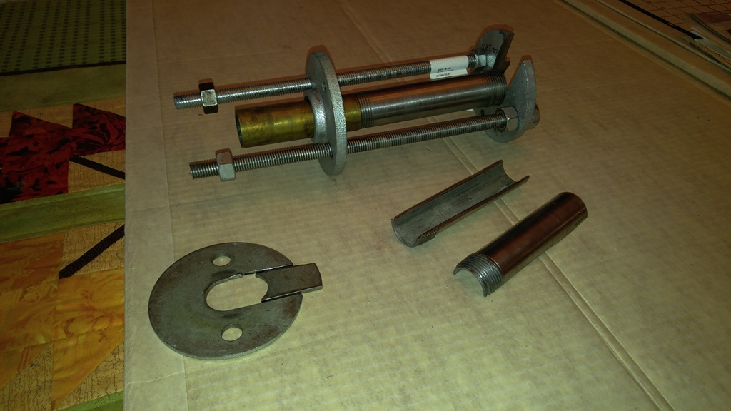

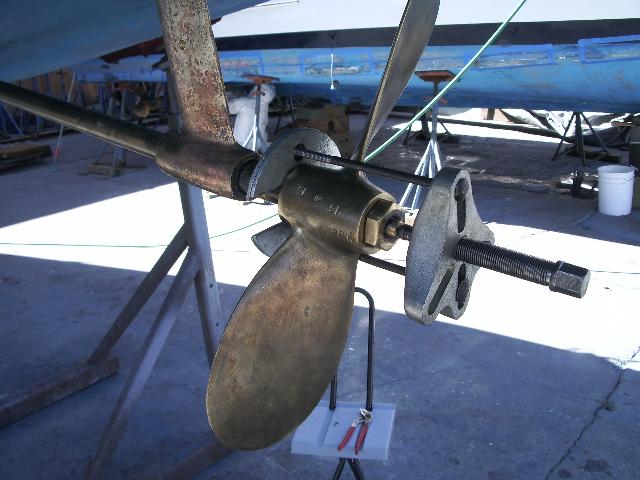

I use a steering wheel puller plus the part I made for my cutless bearing remover to get the prop off. You can see the nut is left in place as it can come off with a bang. I actually only load the puller a little at a time and rap on the side of the prop with a plastic mallet. That has been enough for mine to pop loose. When I reinstalled the prop I just make the large nut snug, not extraordinarily tight then put the small nut on first and jam the big one against it without increasing the torque on the prop.
I've beefed up that saddle part with a 1" pipe flange as the thin one tended to distort. With these parts and the wheel puller the task of removing the prop and cutless is quite easy.
The little round thing referenced above with the hole in the end is just the tip of the machined prop shaft I believe.
