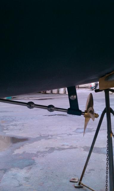

I have a Hunter 33 yacht (year 2009). Its propeller is the standard two wings and I intend to replace it with a three wing one. I would appreciate your professional recommendation per what options we have and advantages/disadvantages of each.

Consider replacing with a low cost 3 bladed fixed propeller at lower cost but may have some drag under sail.

I would suggest that you take a look at a Campbell Sailor prop or a Kiwi. Depending on your budget these props should help your motor & sailing performance.

Mine has a Vari-Prop. A little more expensive, but really makes a difference in reverse and less drag while sailing.

I also have a 2009 Hunter 33 and replaced my 2-blade with a low-cost 3-blade. Huge increase in power and stopping ability - but - there is definitely some drag when under sail, and it is made very apparent by a very annoying whirring noise from the prop if the transmission is left in neutral. If you have the money for it, go for the vari-prop.

Thanks guys. I'll check the Vari-Prop. Hopefully it is not TOO expensive. Any ideas of potential manufacturers?

Do check out Campbell Sailor Prop from North By West or is it West By North..??? just google the prop name will do. Its not ex and not too much drag. Best bang for bucks.

Meirgerner, I also have a 2009 H33 but mine came with the 3 blade 14" prop (part of the Mariner Package). On the upside I can say that I love it! The boat stops on a dime and has a great reverse, additionally, there is very little or no prop walk. On the downside there is a lots of drag. At 5 kts it audibly vibrates and can be heard throughout the boat (I run with the transmission in reverse). I have considered a vari prop just because of the vibration and reduction of drag (I would also like the .5 knot increase in speed as well) but it is hard to justify the $3000+ cost to do either of these. Especially when the Admiral gives me "the look" for suggesting it... LOL
