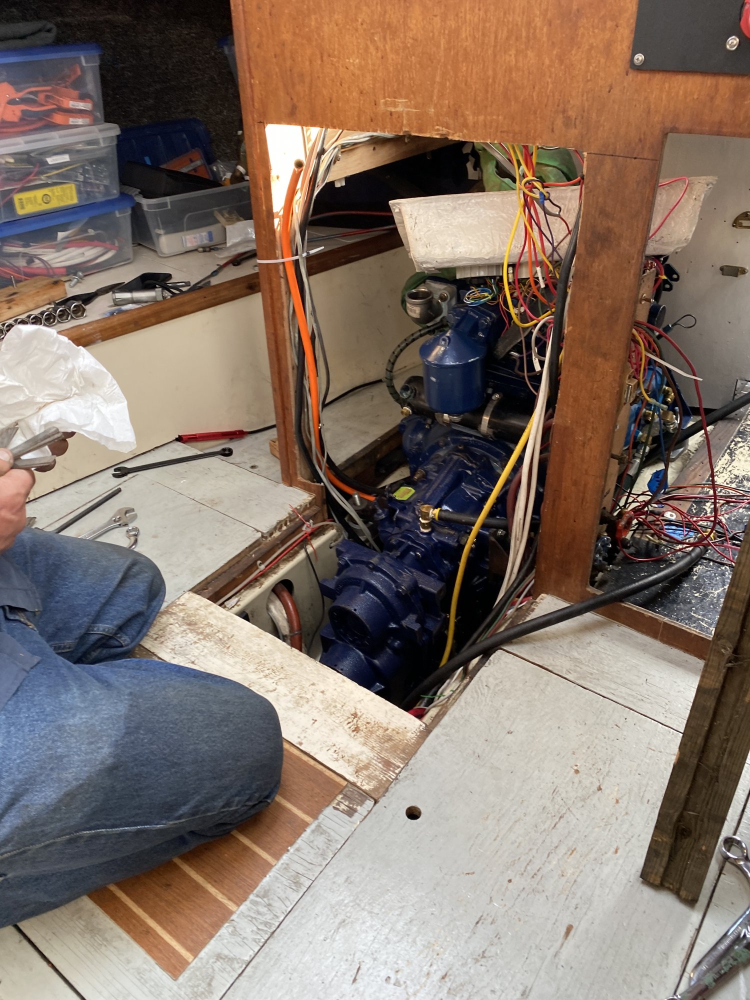

Now that you have accomplished this task, are you ready to try and do it with a V-Drive?
The shaft coupler is beneath the engine on the other side of the transmission. To accomplish the task one needs to get intimate with the transmission. Wrap your arms around her and snuggle up close to reach the coupler.

Jeez Jim (jssailem), that's a bugger. Kind of like the original VW Beetle wherein one had to pull the engine to change the spark plugs!
