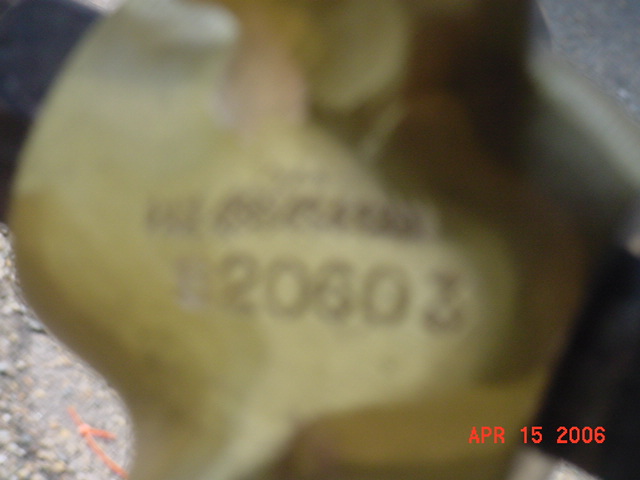

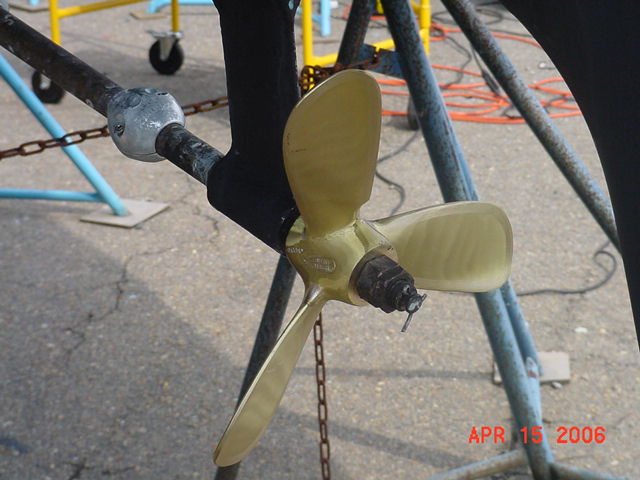

Replaced two blade with 3 blade on my H30'
I have replaced my two-bladed prop with a Campbell three-blade on my '79 Hunter 30' powered by a YSM12. The performance improvement was smaller than I expected. The rpm tops out at about 2200 before starting to push black smoke. One unexpected hitch was the shaft was coupled by two square headed set screws. These broke and scored a grove in the shaft until one sailing day coming back into my marina the shaft just spun with no power to the prop. I had to have the marina pull my boat and replace the shaft with a stainless steel one and reset the engine and rebalance. Must say the boat never ran better after the repair.

Ian: I do not know what the rated RPM of that engine is but you may want to talk to Norm about repitching that prop so you can run it in the recommended RPM range. The fellow in our marina with the same boat/engine had measurable increases in performance.

I am trying to make out the numbers..........is yours a 12 x 6?
