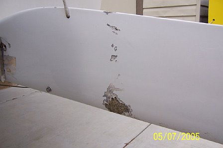

One of the first things I did to my boat was put a prob guard on the motor. The original rudder has some huge gouges in it from hitting the spinning prop. I replaced the rudder with an new Idasailor rudder and wasn't about to let it have the same fate.
