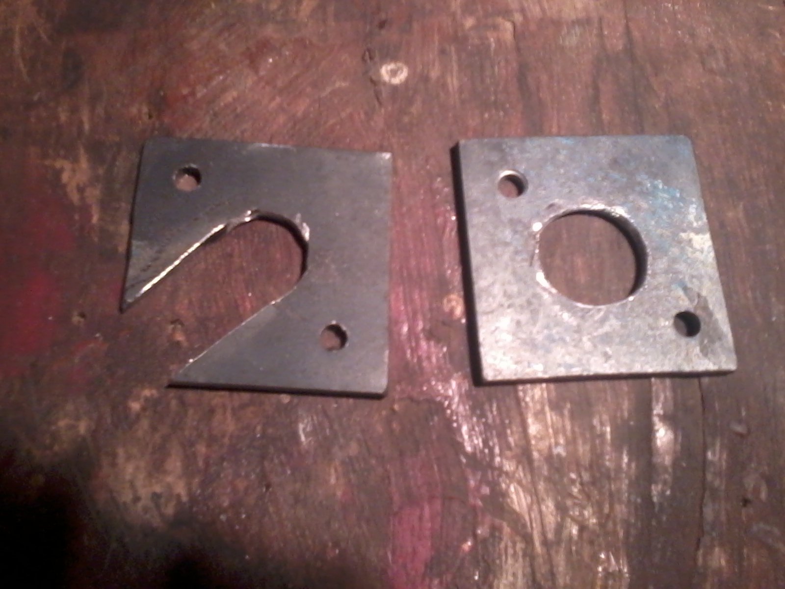

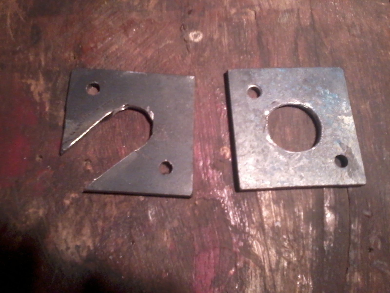

  1. Threaded rod should be about 18" long; 2 pieces with nuts and washers to fit.
  2. The two pieces of steel plate need to be about 2" x 4" wide (see attached photo)
    1. For the piece that fits forward it needs to have a hole cut that is 1" (just large enough to fit over your shaft). You also need to make this piece a slot so it can slide over the shaft.
    2. For the piece that goes aft, it's hole needs to be 1.25" as you will push the old bearing through it and that does not need to be slotted.
    3. For both pieces you need to drill holes so the threaded rod can fit through.
  3. You also need 2 pieces of 3/4" copper pipe of about 4" long. You want to cut these with a hacksaw down their length and they will need to be expanded a little so they fit over your 1" shaft.
  4. Finally you need two hose clamps big enough that they can fit over your shaft and hold those four copper pieces in place loosely.
  5. To use you have your prop off, slide the metal piece with the hold over it. Put the slotted metal piece over the front and connect the two with the threaded rod.
  6. Forward of the strut, put the 4 copper pieces around the shaft and hold in place with the clamps.
  7. Tighten the threaded rod until it is snug against the copper pieces and they are in place against the cutless bearing.
  8. Ensure the holding nut in the strut is loosened and tighten on your threaded rod you move the bearing out.
I will note the first one I made of these was out of some old oak flooring and it worked fine. But, I lent it out to someone who had a cutless bearing that had been in place for 25 years and he used a hammer to persuade his and the tool did not survive, so when I made a new one I used steel.
Does this help?

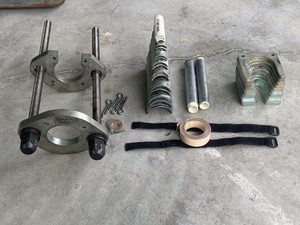

You can also get the StrutPro tool, but those are several hundred dollars. https://i.ebayimg.com/images/g/1REAAOSwathfjDko/s-l300.jpg or this one a guy made in wood Cutless bearing removal.
