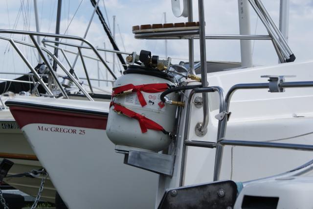

I had to custom build mine as none are on the market that I could find. Any welding/fab shop should be able to build one for you. Here is a pic of mine, very simple and basic. Gary.

Luke:
Here is a link to the Trident LPG lockers. Have you considered one of the Seaward units? They can be installed in a locker so they do not look so bad and are also slightly less expensive too.
