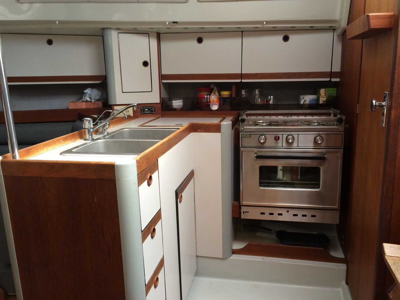

I have a Catalina 30 TR from 1982 with Force 10 propane stove. The owner of the boat (I coop) says she smelled propane and disconnected tanks. She and I would like to get it working. I did a brief inspection and I am pretty sure it is not up to ABYC standards for safety. Wanted to get your feel and best recommendations to make it safe. The stove was "updated" from alcohol stove in 2005. I admit I am used to either kerosene, alcohol or butane portable stove. Propane grills are awesome, but in a boat I am hating the fear of explosive gas sinking into bilge. I get that they can be really safe, but I am tempted to just redo this system. Is it cost effective and what I am I looking at for cost?

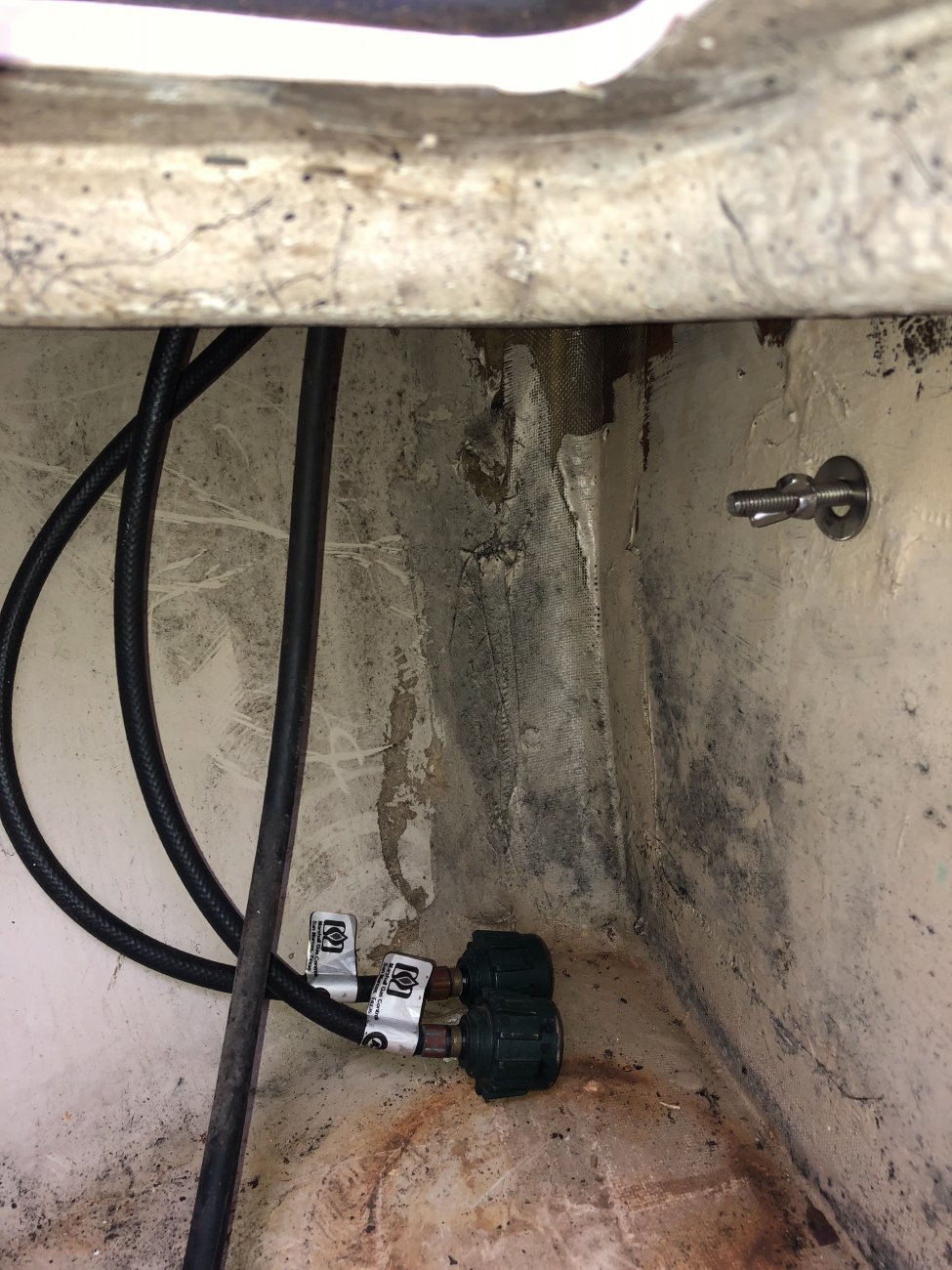

The tanks hook directly to these 2 hoses in rear lazarette. I do not see any solenoid or shutoff within the safe locker. There is a drain in the back of lazarette that goes out just above the exhaust. There is a regulator that allows for a switch between 2 tanks that is in the starboard locker that is mounted on the top of locker.

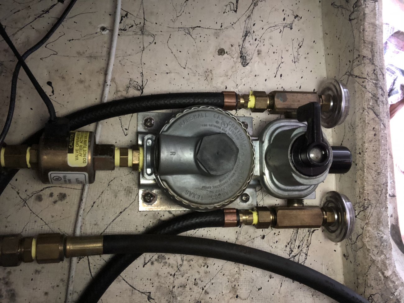

This is in the starboard locker area. This regulator is within the locker that if leaks occur will drop into the bilge area. I am not loving the set up at all. These should be inside the propane locker right?
You can see the rust from the tanks where they are lashed. If I was to have a solenoid and safety shut off at the tank, and run a straight line directly to the oven/stove, that would be safer correct?

Looks like you have a propane cutoff solenoid on the regulator output. Yes, all this and the tanks need to be in a box with a bottom drain sloping to a through-hull above the water line.
Nov 6, 2006
9,984
Looks like you have all the parts.. I agree with Gunni ..The gold cylinder in the regulator outlet is an electric solenoid shut-off valve.. All the lids and bulkheads should be sealed and any wiring and hoses should have air tight "pass through" fittings..

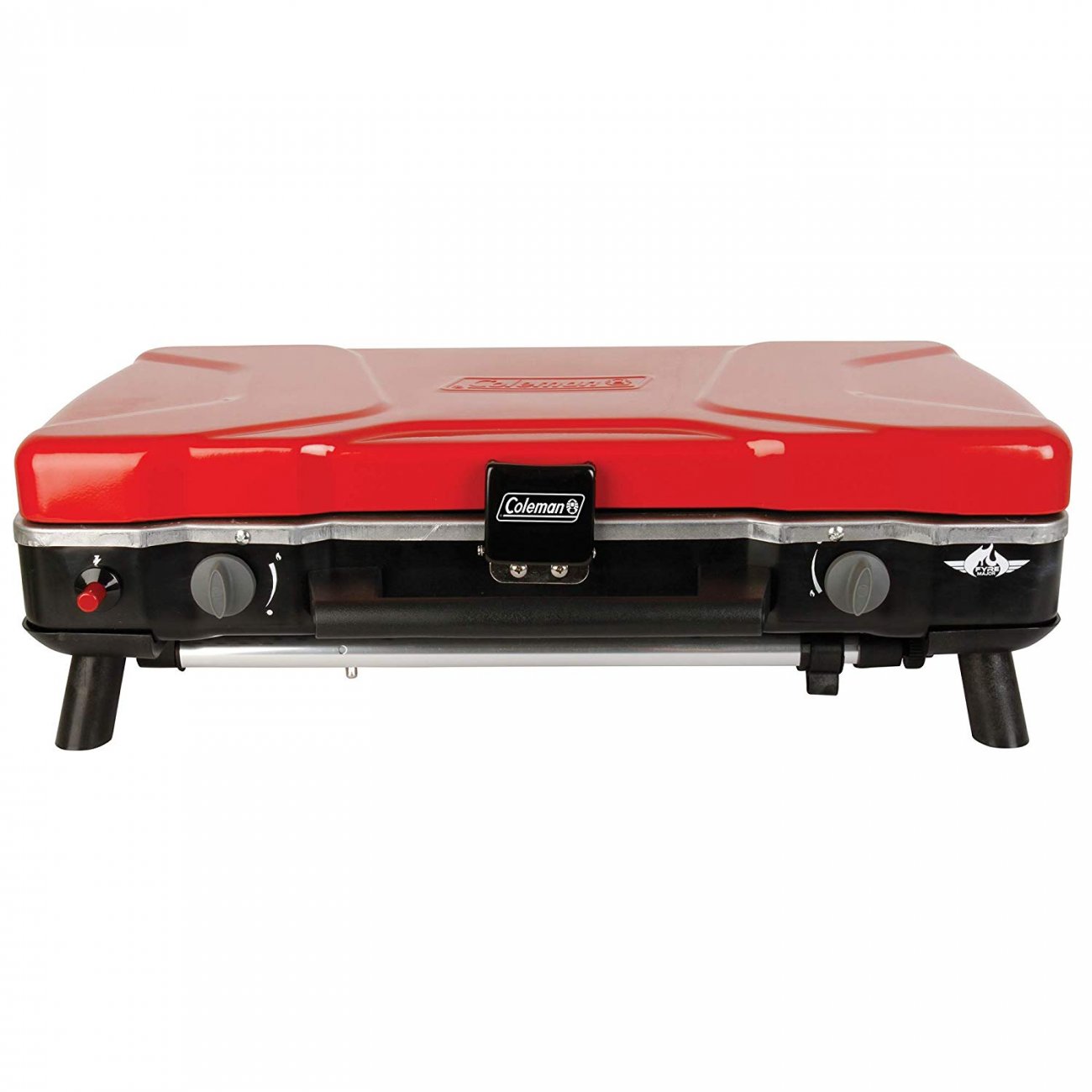

Here you go @Ward H $85 on Amazon.
Coleman FyreMajor 3-in-1 Propane Stove
I have one of these sitting in my cabin until I get my Force 10 up and running. Uses the same gas containers as the Magma.
