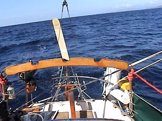

Kito,
We went with the 6 Lb. upright tanks. I got a stainless steel fender holder and the tank fits in it just right. The photo below shows it with a white Sunbrella cover on it (right side of photo).
This is a photo of it without the cover.
You can see our full installation with photos at;
http://www.svguenevere.com/prep/proj/stove/
EASY!!
