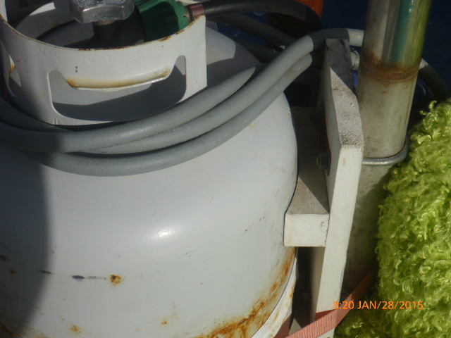

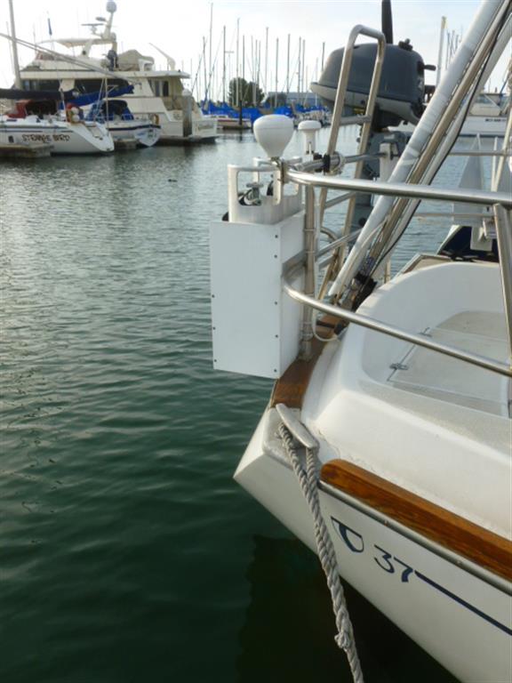

This picture is not from my boat. But it shows the top of a rail mounted propane tank and it's wooden support. The support had a shelf on the bottom and angle pieces to hold the shelf and side screwed together.
I took this picture because my unit does not have the curved support piece to prevent the tank from rolling thwartships and I wanted to remind myself to add this support.

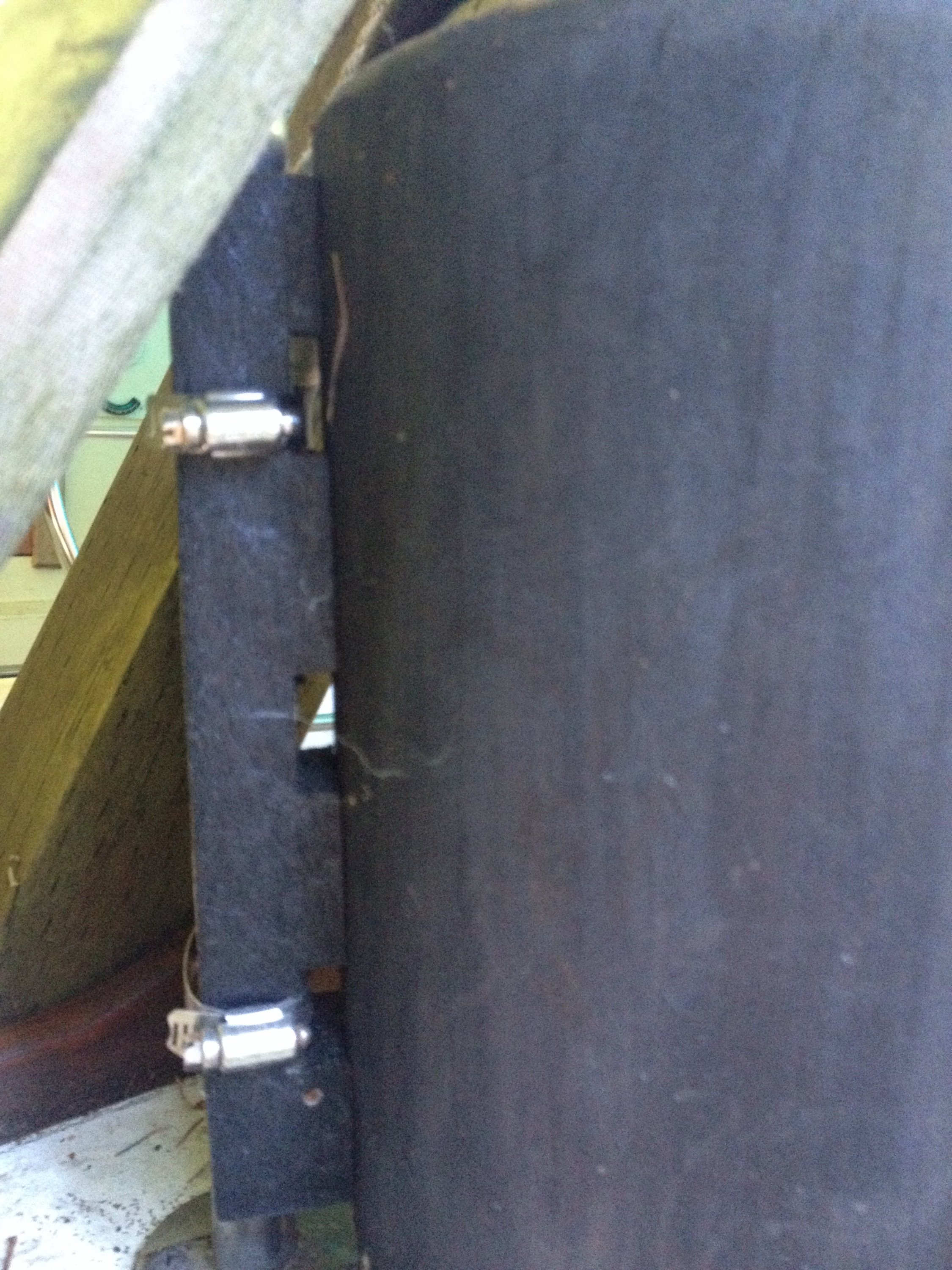

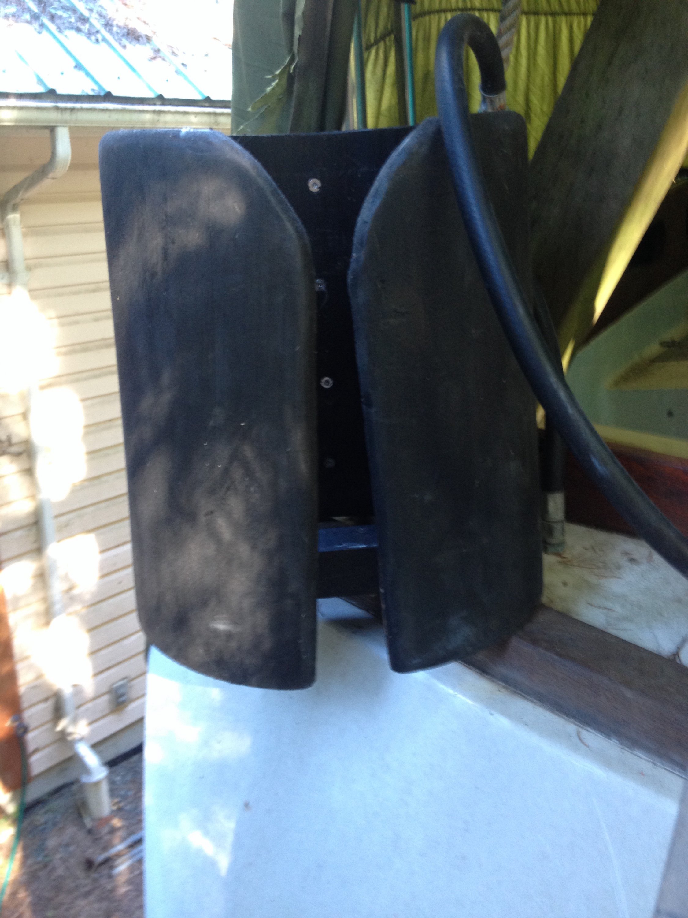

I built a propane holder out of a split piece of polycarbonate pipe that clamps on my stern rail. It spreads open when I push the cylinder in and hold it very secure when in rough seas. I'd send you a picture, but I'm at sea for another week!

image.jpg image.jpg Here are some pictures of the pipe one that I built. I got the idea from dive bottle holders and works extremely well. I'm sure someone could make something more aesthetically pleasing than mine with little effort.

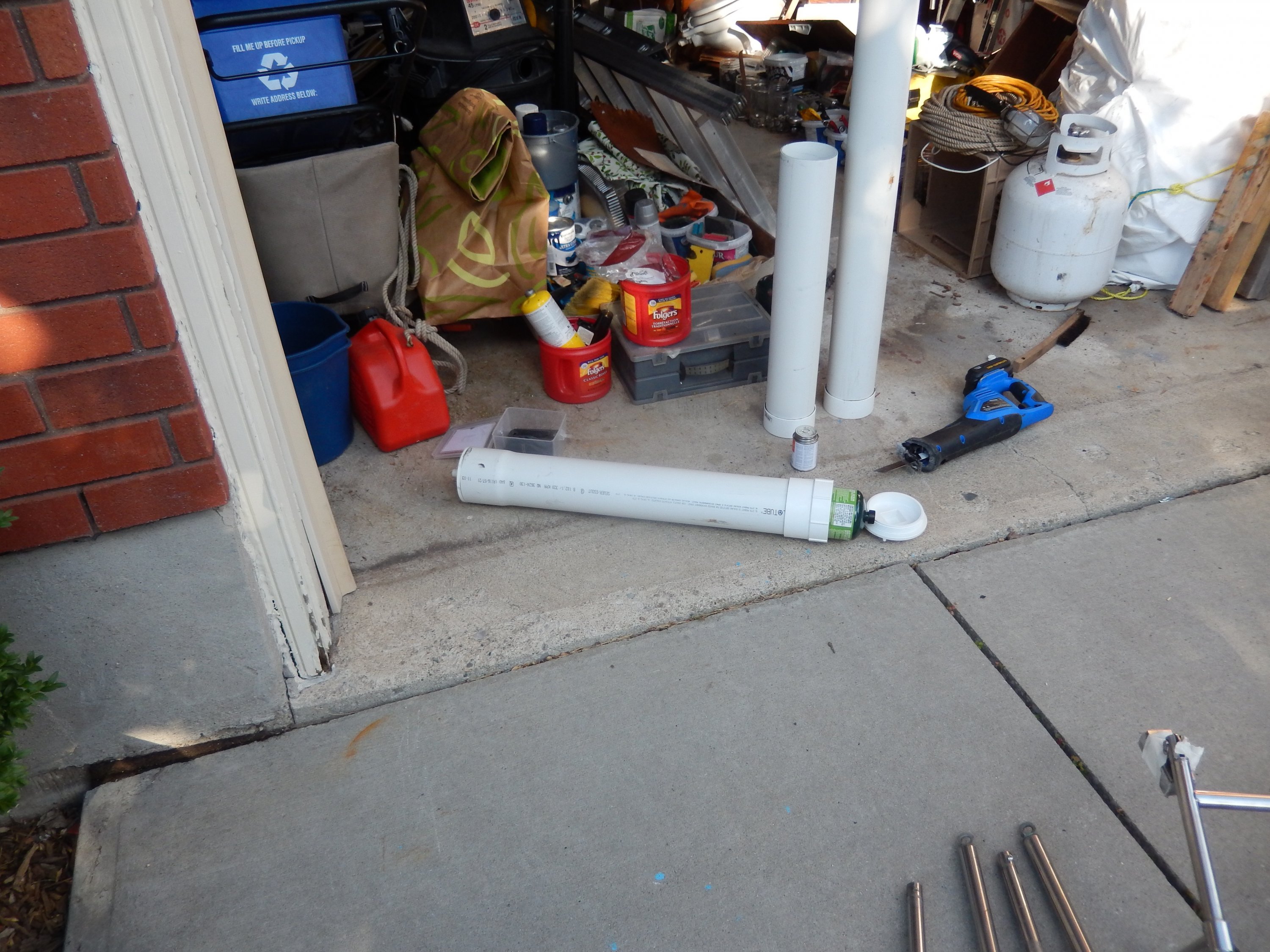

If you use the small propane cylinders such as those made by Coleman then here is a simple propane locker you can make for less than $20.00. This locker will store 3 partially full, full or empty propane cylinders. You need 1 30" to 32" length of 4" white PVC tubing (4" id), 1-4" x 1 1/2" fitting with 1 1/4" x 3/4" hose connection, 18" of 3/4" id tubing, 1- SS screw clamp for tubing, 1 - 4" socket x 4" threaded fitting, 1 - 4" threaded plug, 1 - PVC solvent cement, long nylon quick ties or long SS screw clamps. For this application primer for the PVC should not be required. To mount the completed storage container fasten to a stanchion in the rear cockpit by large nylon ties or multiple screw clamps and hang the tubing over the stern below the gunwale.
