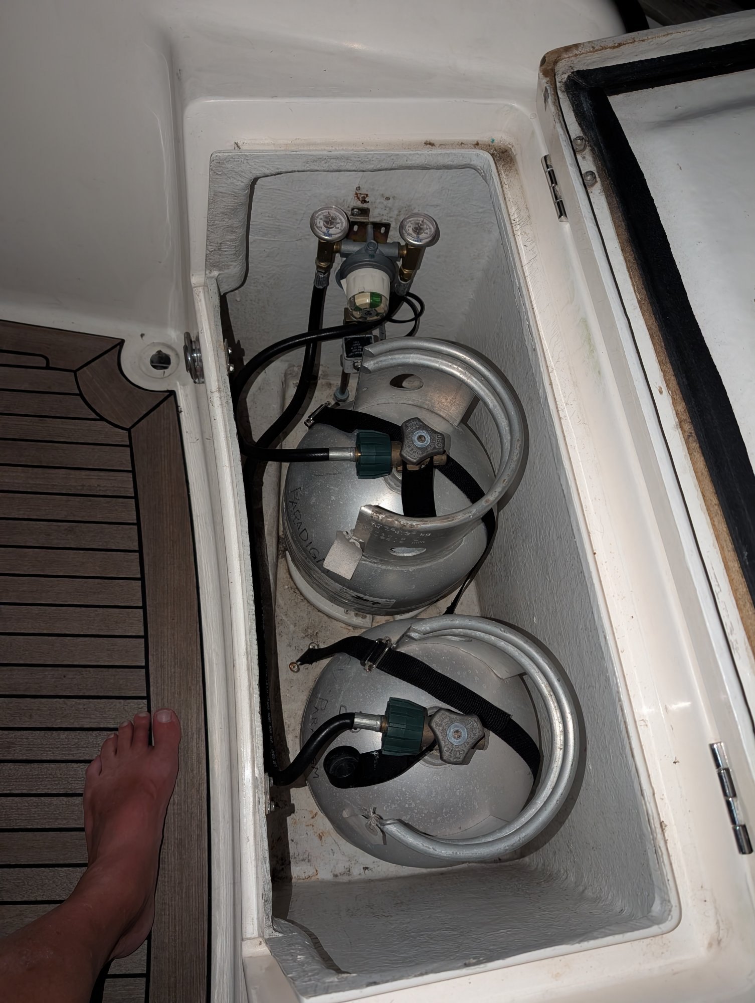

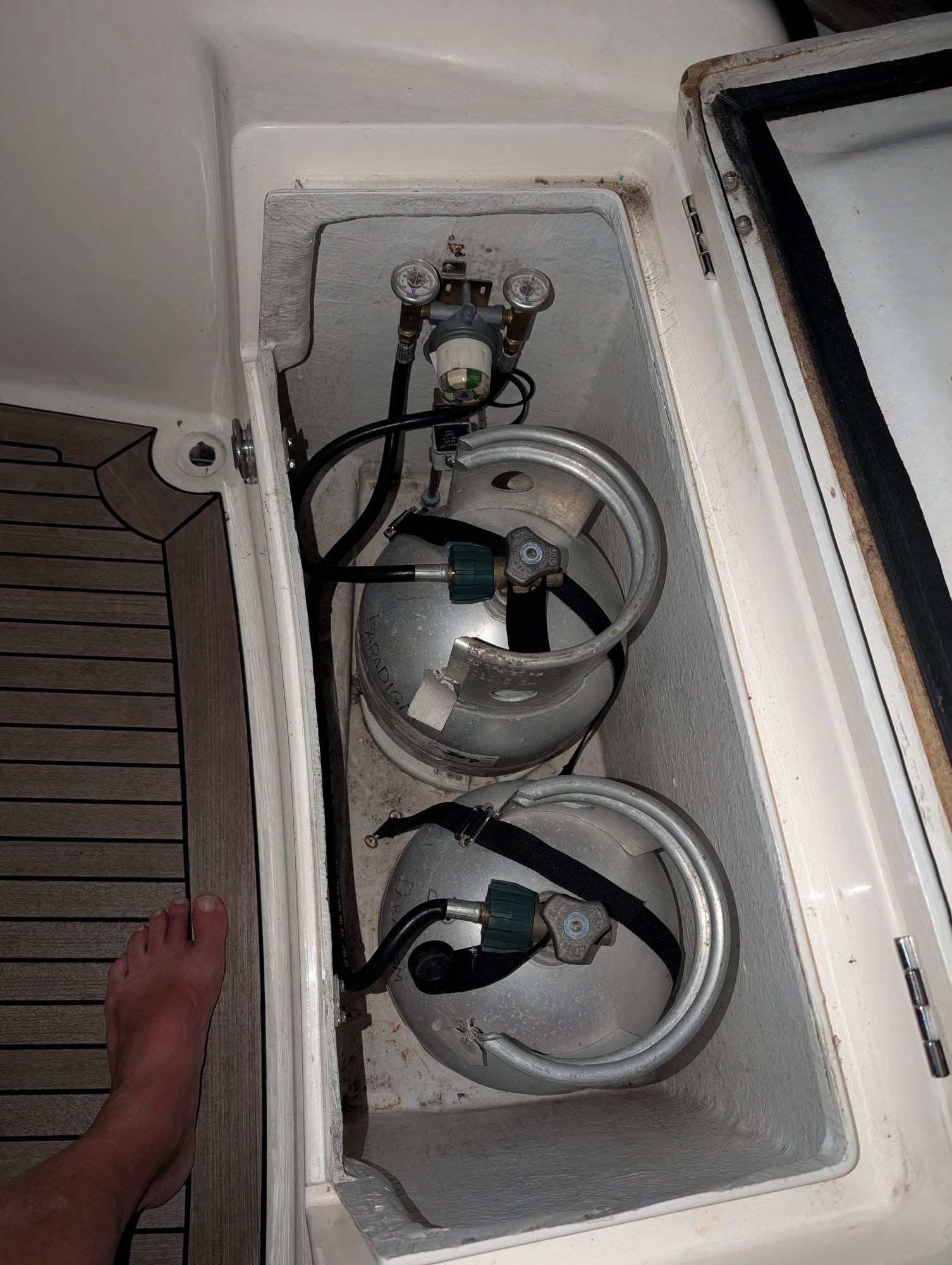

Here's a properly set up dual propane tank. Each tank has a high pressure line running through a pressure gauge then into a regulated manifold. That's a special manifold I believe that will not allow back streaming - not real sure how it works. Then you have the solenoid shut off valve where the line connects to the supply line to the boat. All of this is in a sealed locker with a vent in the bottom that would direct any leak of propane to go directly overboard.
You can turn on either tank or run both if you want. You can also take one tank out to go fill while running on the other tank - no problem...
I personally would not want tanks just hanging out outside as one could get airflow pushing propane inside the boat. YMMV

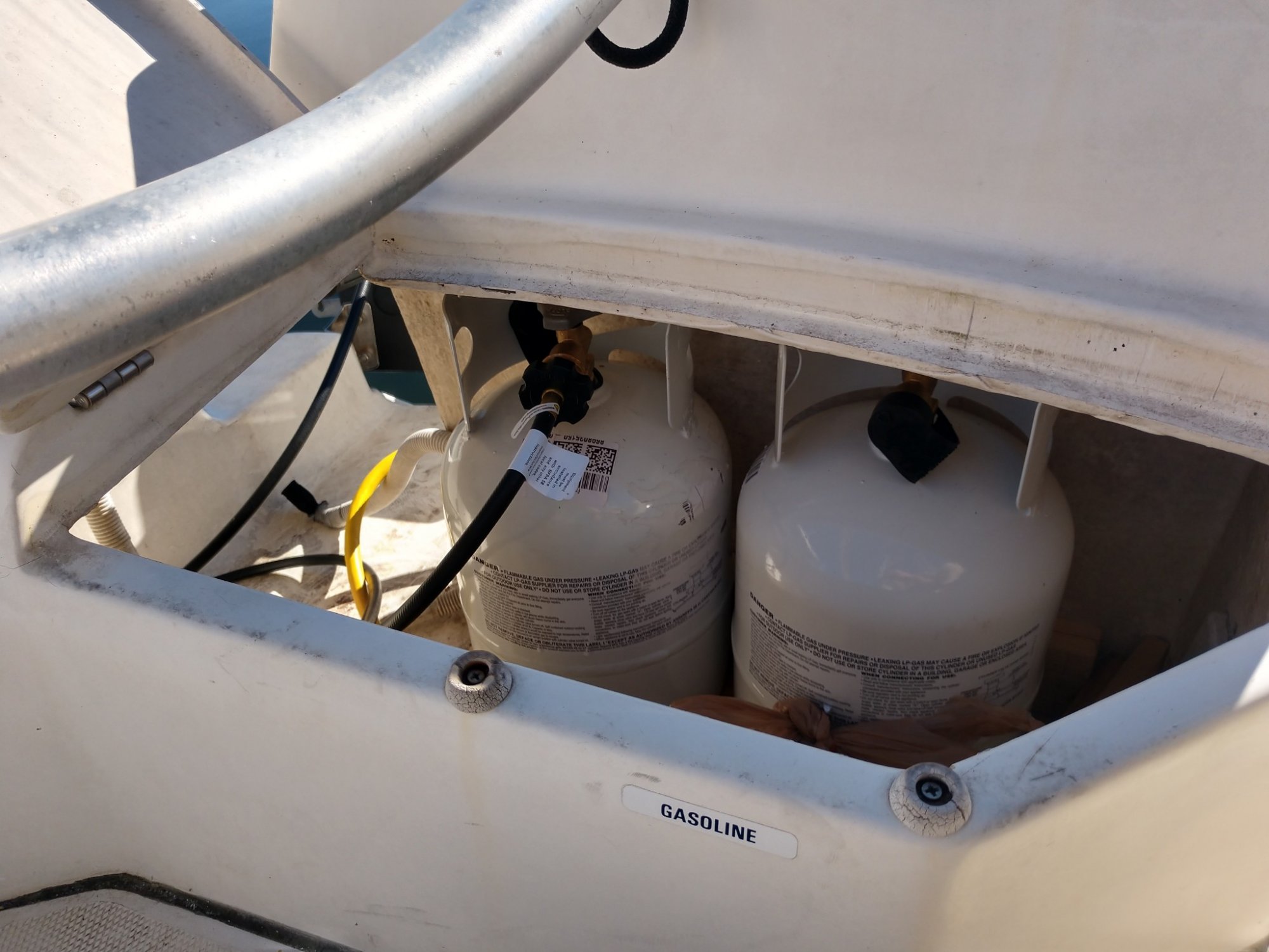

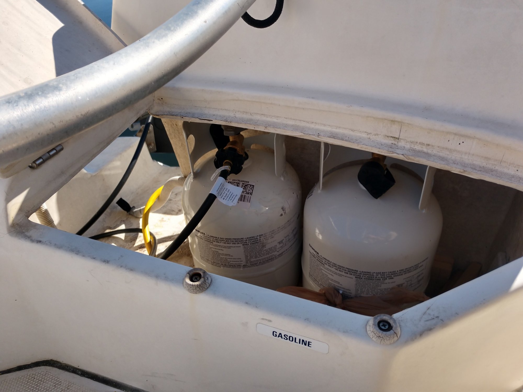

Is it really a good idea to store gasoline and propane next to each other?
Probably not the safest configuration; however, main criteria is that there are no flame or spark emitting devices in the locker or near by. I haven’t a clue what coast guard or ABYC regs are for storing two dissimilar fuels in same dedicated space.
May 1, 2011
5,294
Pearson 37 Lusby MD
And what about the overboard drain for the propane "locker"?
Jun 21, 2004
3,055
Beneteau 343 Slidell, LA
Appears that the aft end of the locker is open, so I guess that could meet the vented / overboard drain space requirement??? The manufacturer has a ”gasoline” label on the locker, so they must have designed the space for flammable storage??? Don’t know, just guessing.
