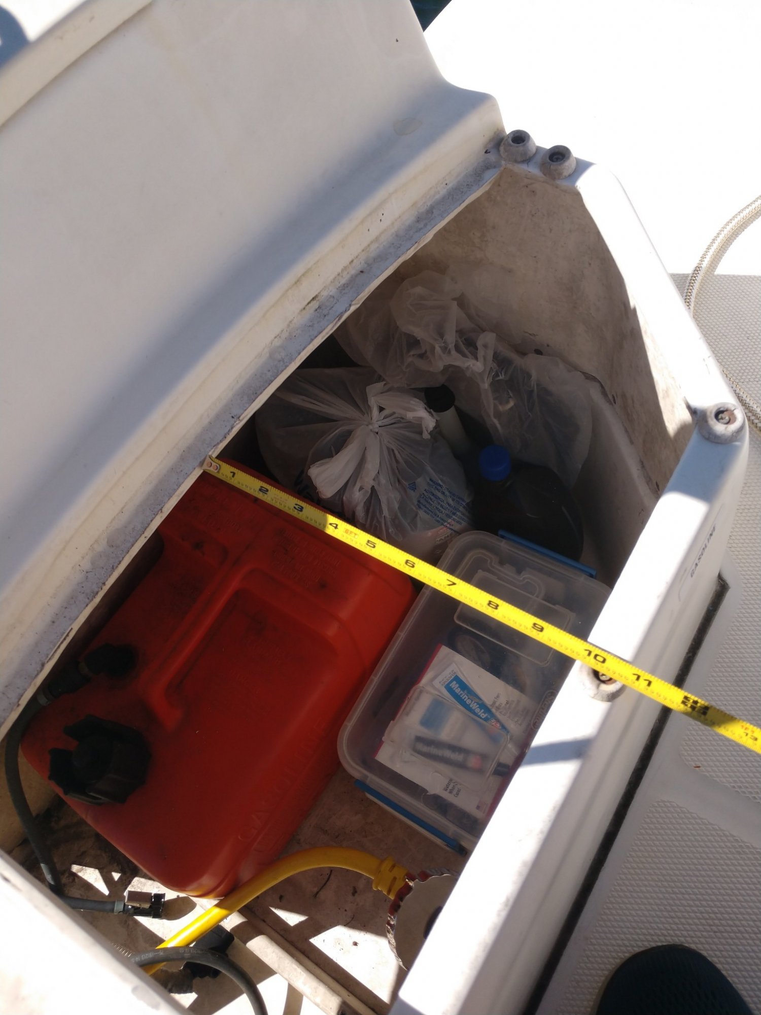

Does anyone have any experience with propane outboard motors? I am thinking of a 5 hp Mercury for a Hunter 240 if I can't get my Honda running again.
Update 10-23-2021

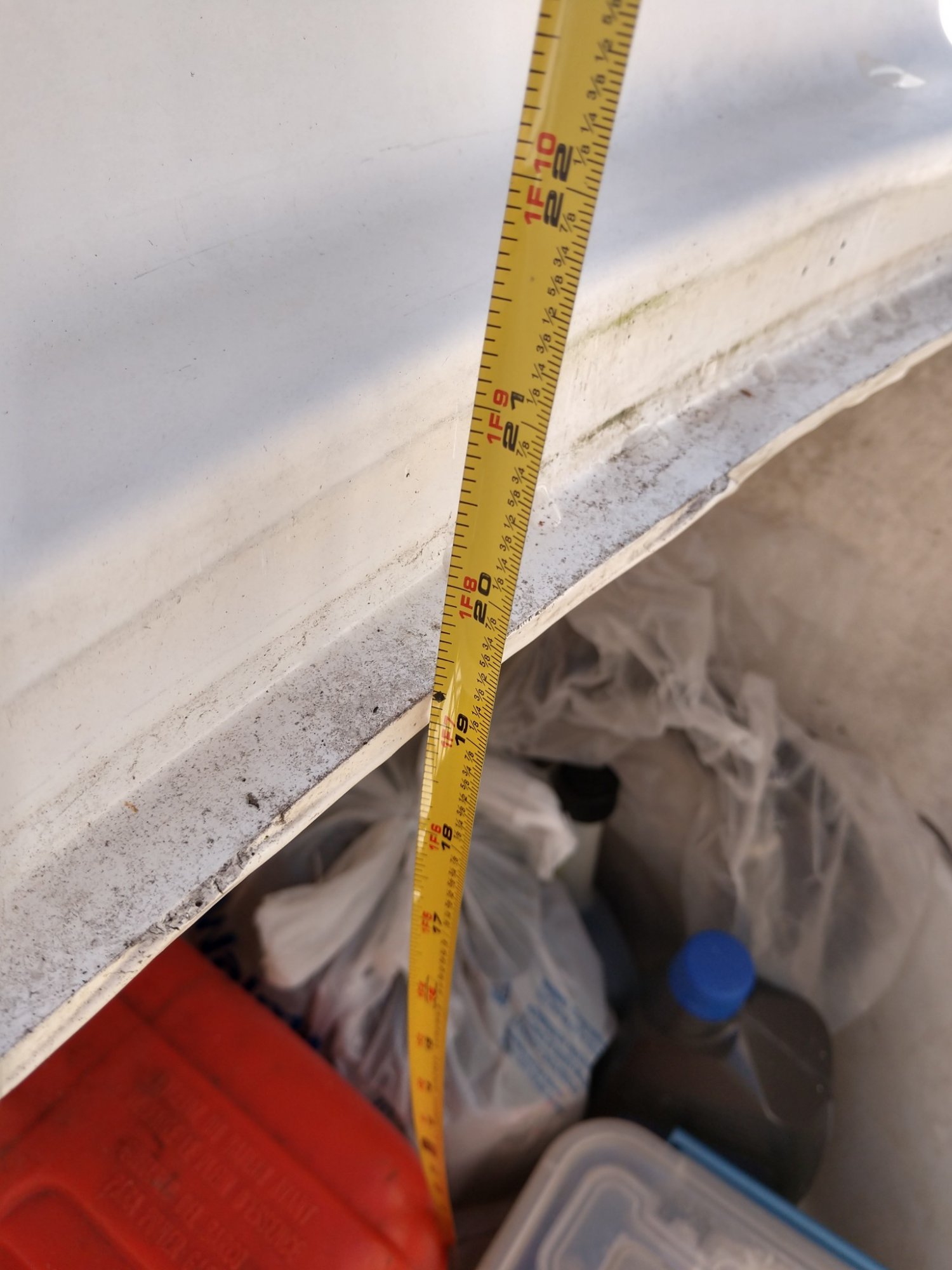

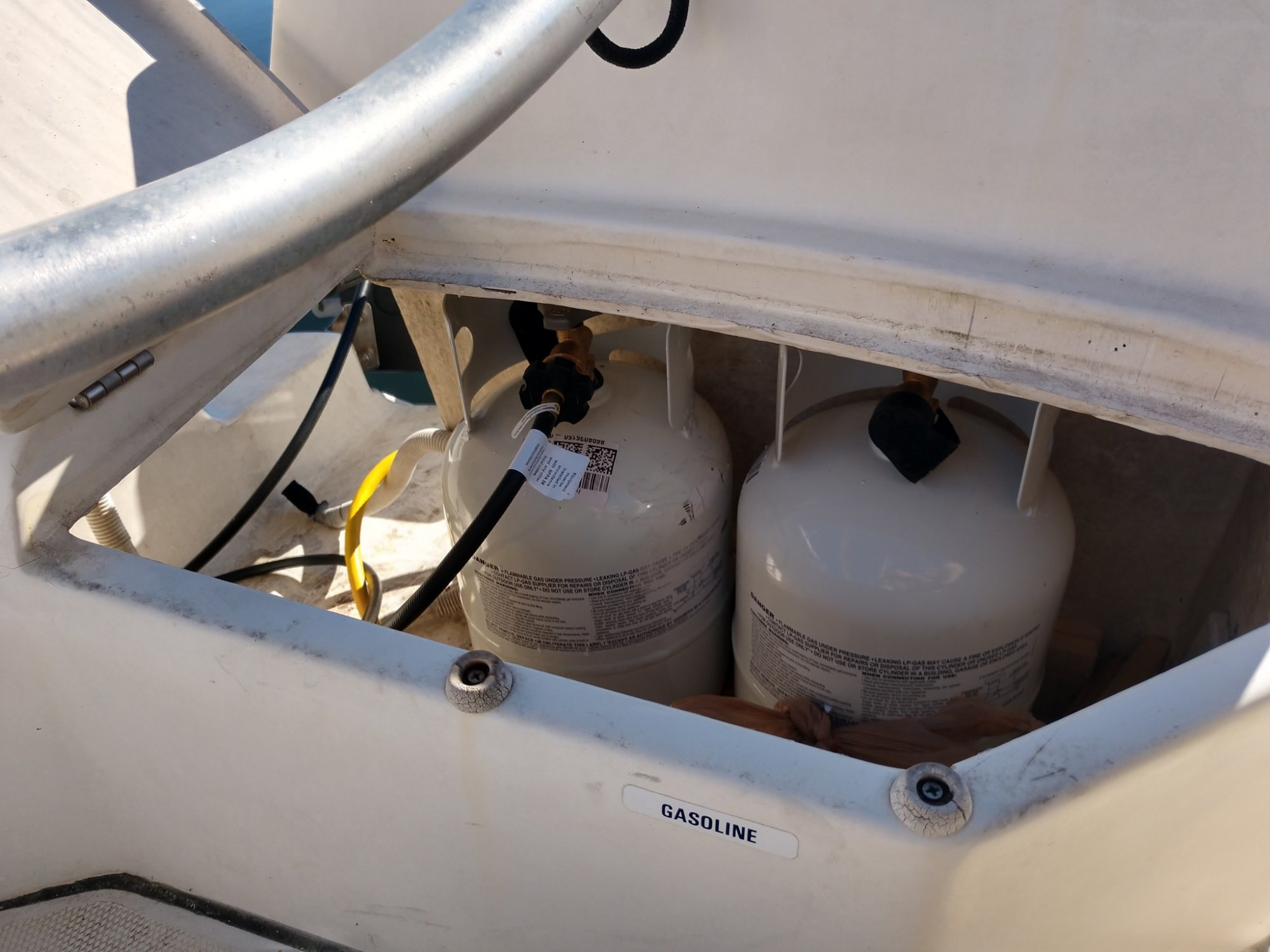

I have ordered a Mercury 5 hp Propane outboard from West Marine. It will be here next week. I will pull the Honda and work on it at home. I plant to back the boat into the slip, and with a sling, pull the motor onto the dock. I should take three guys to do it safely. It weights 90 lbs. The Mercury is less than 60 and should be a breeze. Two 11 lb. tanks should fit in my gas locker under the stern seat as the tanks are 18" high by 9" and the compartment is 19 inches tall and the hatch opening is 9 3/4 inches.Fuel Compartment a.jpgFuel Compartment b.jpg
I like the Honda but I feel that it is too heavy for the mount on the H240. I only need a motor to get in and out of the marina and the Mercury should be perfect. The cost was a tad over $1,800.00.

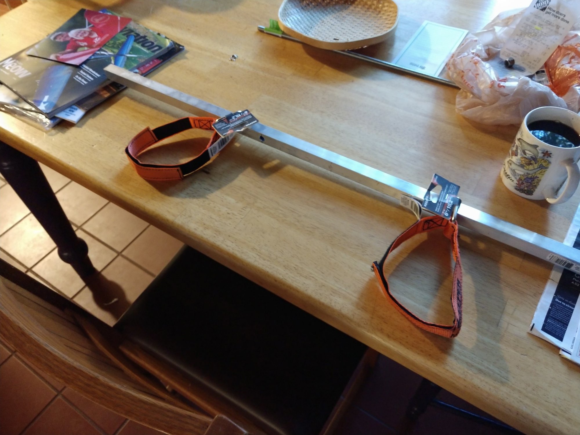

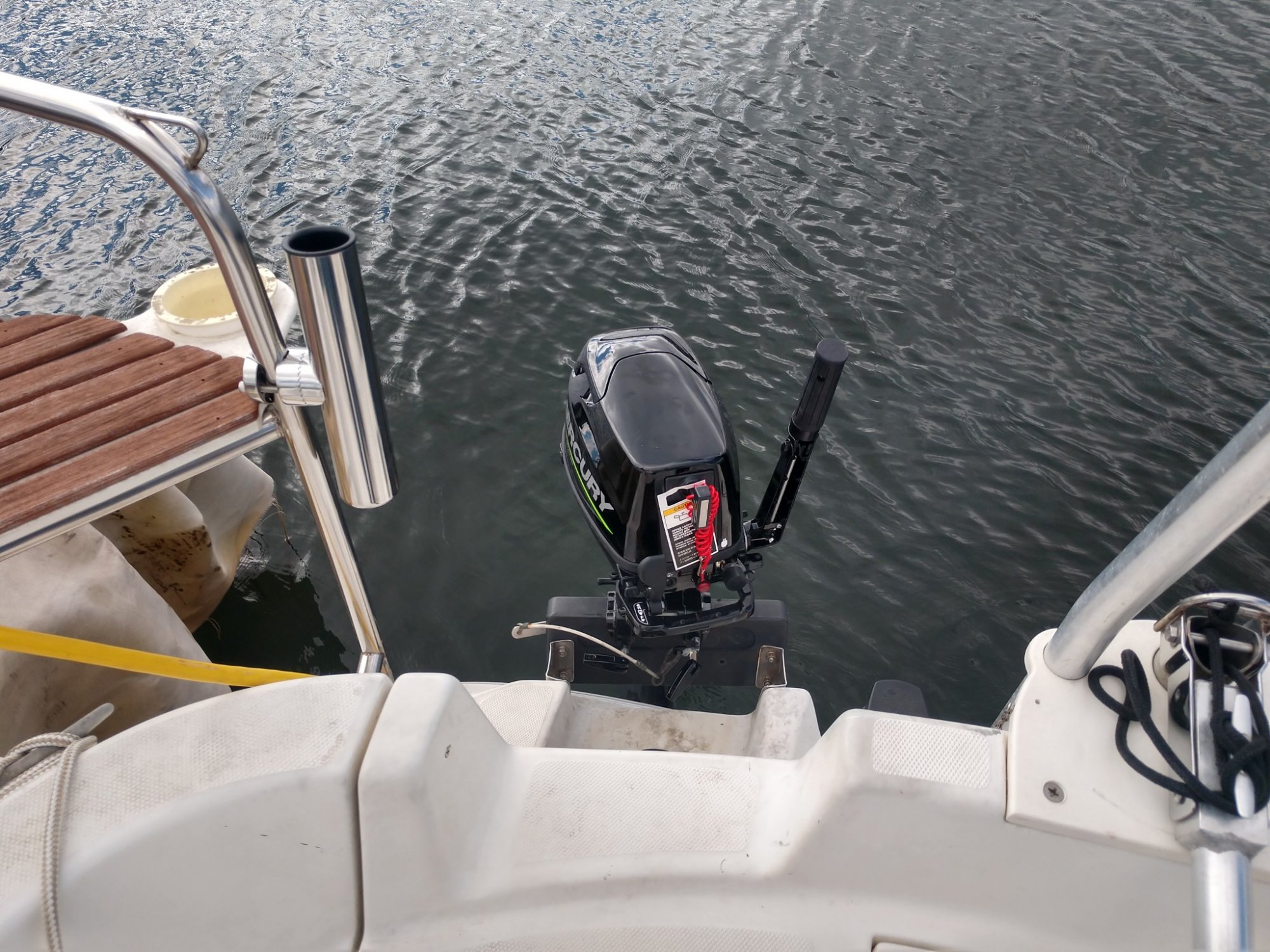

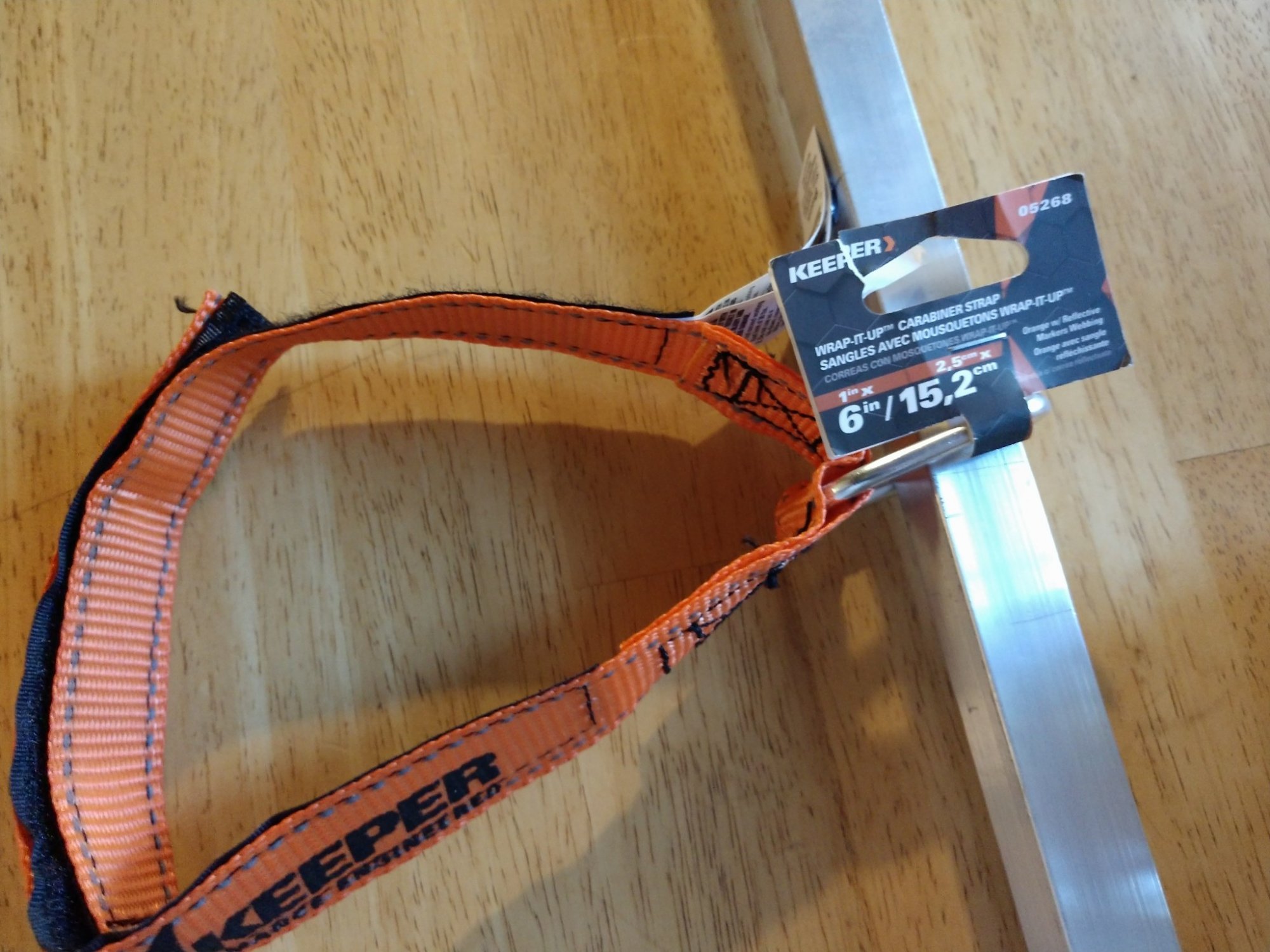

Propane update. I have installed the Mercury 5 hp outboard. I have twoIMG_20211107_080343004.jpgIMG_20211107_080351339.jpgIMG_20211108_145841896_HDR.jpgMercury on Transom.jpg 11 lb. tanks that fit in my fuel compartment ( there is space for a 20 lb but the hatch opening is too small to accept it). I notice no difference in performance between it and my Honda 8 hp which I have brought home to clean and repair. The Hunter 240 has two long bolts that hold the upper hinge plate for the rudder post. They extend into area above the fuel compartment and I have hung a square aluminum tube with supports for the tanks.
