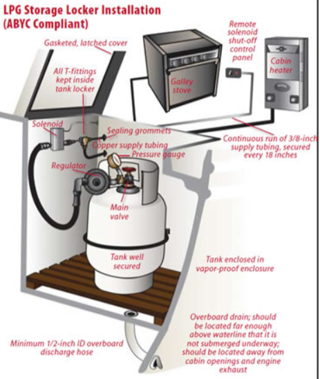

My propane Is tank currently mounted on my aft rail and gets in the way.
What are the options to install in inside of an aft locker? I have a 1991 Hunter Legend 35.5 with
the tank I’m using now is a steel 5 lb.
I have a propane stove and bbq that will be drawing off of this tank.
Has anyone modified there aft locker to hold a tank safely ?
You need to isolate the propane locker from the interior of the boat and provide a drain that will allow free propane to exit above the waterline. Drain must fall all the way to your through hull.

Some considerations below with links to threads on this subject. Others may have made this conversion and can offer their experience:
1. LPG locker must be a dedicated and sealed space. Could accomplish that with an LPG locker and install that in the aft locker (Propane (LPG) Lockers). In addition, all non-LPG system items-shackles, tools, etc.-must be removed as they can easily damage system components.
2. Make sure the locker opens directly to open air.
3. Provide a dedicated thru hull 1/2" minimum diameter drain at the bottom of the locker that vents directly overboard above the water line far enough away from other opening (air intakes, sink or bilge pump discharges, engine exhaust, etc.) that could allow gas to re-enter the hull; ensure the locker vent hose slopes downward and is free of blockages, loops, and kinks.
4. Provide a means to secure the tank.
5. Inspect the locker by checking the bottom, sides, and seams for damage (corrosion, cracks, holes) that could allow gas leaks into the boat interior.
6. Provide a pressure gauge, regulator and manual or electrically operated solenoid shut-off valves, which you probably already have, in the locker near the tank.
