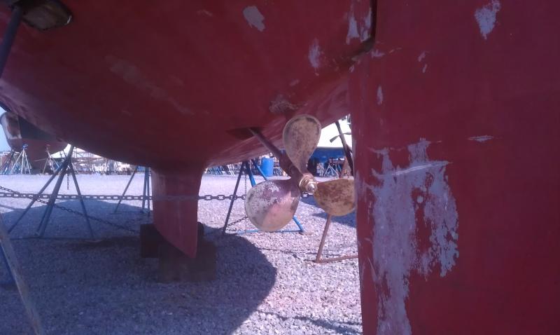

I have a 3QM30H in my 1980 Hunter 37C.
Just did a haul out and had a local yard do a bunch of work:
  • New stainless steel shaft with all new hardware
  • New Duramax Cutless bearing.
  • New PYI PSS Shaft Seal (dry in the bilge, now)
  • Reputable prop shop that made the shaft also touched up the 3-blade prop that was on the boat, I couldn't determine the manufacturer and it's a 15X15 according to the only stamps I could find (front face of hub).
  • New shaft zinc and Pettit Barnacle Barrier to try and protect the new hardware
  • Engine alignment checked and was very good with no required adjustments.
I still get vibration which I can't reliably attribute to the engine (too low of frequency) and the prop wash in reverse has always been awful as long as I have been sailing on this boat.
I'm thinking of going with the often recommended 16x14 Michigan Wheel Prop. I'm wondering if going to larger diameter and a smaller pitch should still give me the push that the boat needs in the Chesapeake chop, while reducing the vertical component of the wash which is driving me sideways instead of backwards... I'm going to be asking the local prop shops, hoping to get some input from other H37C owners in addition. I am only considering fixed props for reliability and maintenance matters.

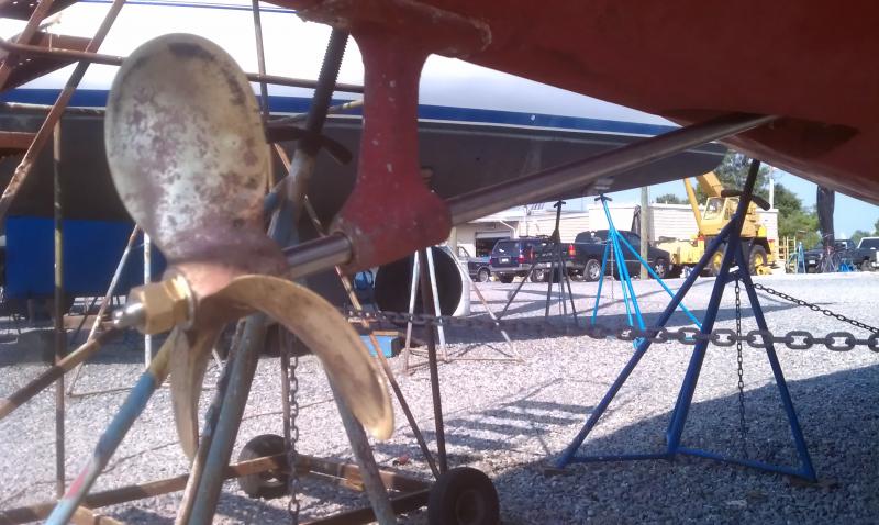

You are clearly serious about your vibration problem because of all the trouble and expense of all the work you have had done; otherwise I would not have been so bold as to offer an opinion.
But to my eye, your photo of the amount of overhang of the prop behind the cutless bearing is simply inviting vibration or whirling of the system. It may seem drastic but if the boat has always had this problem then a shaft with the prop as reasonably close behind the bearing as possible, e.g. 1/2", would provide much more rigid support and much less leverage of any out of balance loads, both dynamically and hydrostatically, back on the engine and its mountings.
The mounting of the strut looks to have sufficient rigidity and one presumes the bolts are tight; also presumably the engine mounts are okay - so it has to be something else.
A new shorter shaft need not be too expensive or you just need to borrow something to slip into place for a test and then have the new one shortened if the test is satisfactory. No need to go to the trouble of re-aligning to the last thou for this check. The prop shop or machine shop that made your new shaft may be in a position to help.
BTW I even worry about leaving sufficient gap for a line cutter.

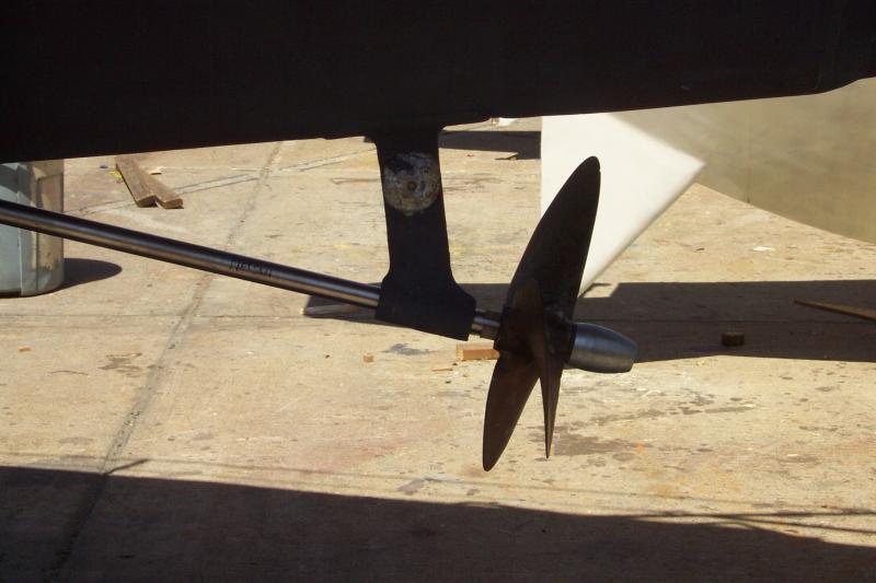

Per the surveyors recommendation we had the prop shaft shortened on our HC 37. This is what it looked like afterwards. The rudder is removed.
Later we went to a flex-O-fold prop and love it. The prop walk never goes away but you can either use it to your advantage or learn to briefly gun it and then steer as soon as some speed has built up.

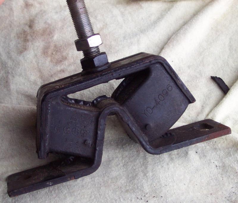

I would also inspect the mounts. The attached picture shows what a bad one looks like - it is bulging on one side.
The highly respected yard manager also said we had a mixture of mismatched mounts before we had ours replaced.
It actually made little difference and we did not have much vibration before anyway but I still felt good about having done it.
