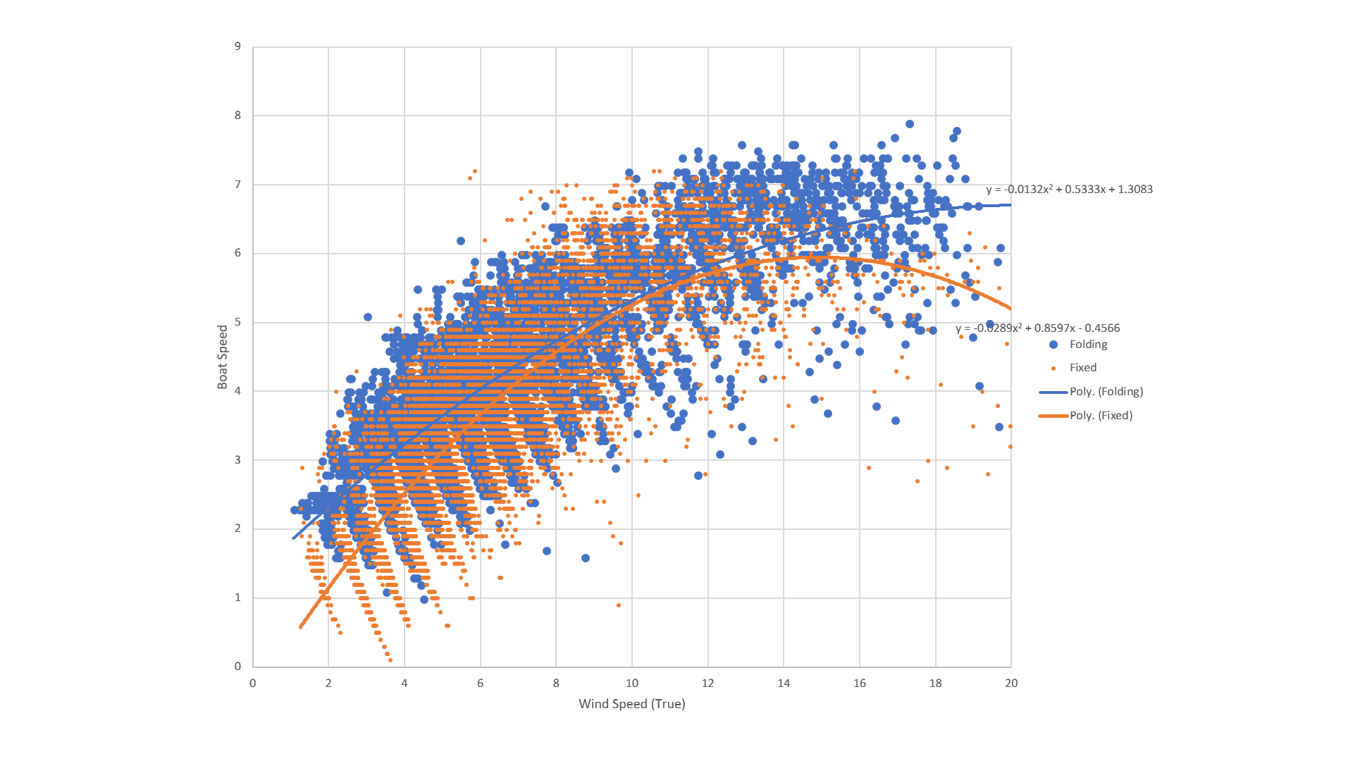

May 17, 2004
5,704
Yes, that's more than 50% larger than mine. Thanks for the clarification. Any thoughts or data on drag while sailing?
Here's a comparison of my close hauled boat speed from races over the last few seasons. Orange dots are the OEM fixed prop, blue are 3 blade FlexOFold. Solid lines are best fit trends. Basically at low wind speed the FOF is about a knot faster. Close to hull speed the speeds match. At high winds speeds the fixed prop made lots of turbulence in front of the rudder so it took a lot of rudder angle to overcome weather helm, slowing the boat again.
Caveat - The FOF was the last season, so some of the speed improvement may come from having learned the boat better.
Likes: Gunni
23,263
@Davidasailor26 The record shows significant speed improvement. Bet you love the FOF.
