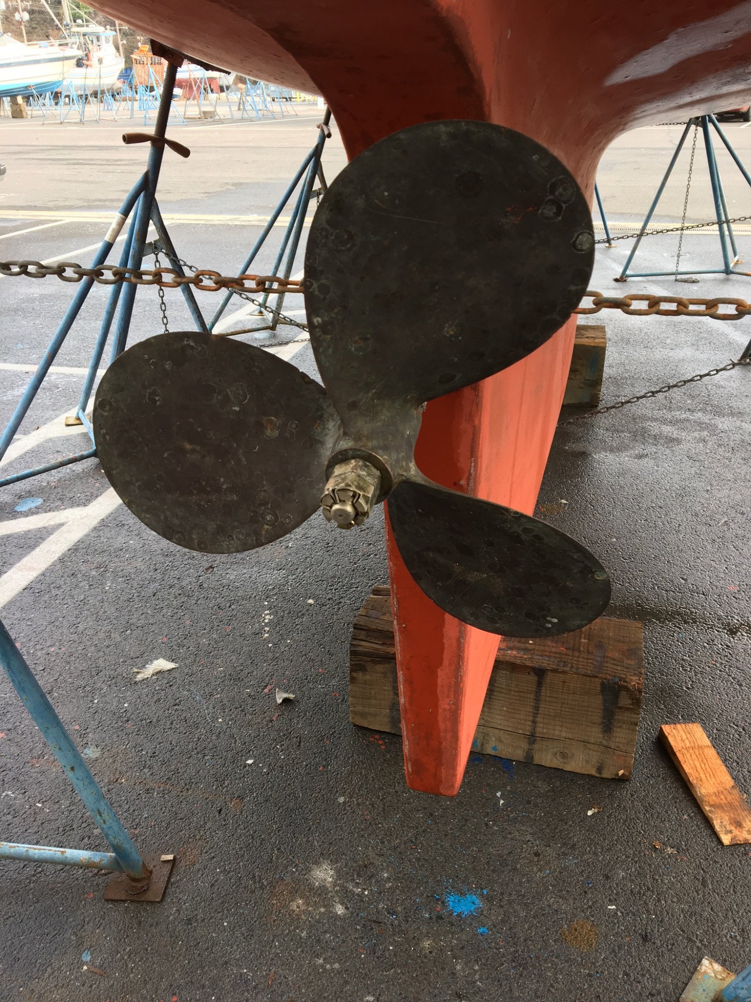

I have the same boat with the same engine, fewer hours. I have the original two blade prop and make over 6 kts at 3000, run her at less. I don’t have any serious issues at the dock other than changing direction from fwd to aft doesn’t always happen as quick as I would like ( or need in a following wind). My engine is not consuming any noticeable amount of oil, but my rear gets a little sooty, not a character flaw I hope. I think the two blade will serve you well, albeit your advancing hours may require attention, I am having my injectors serviced year end.
