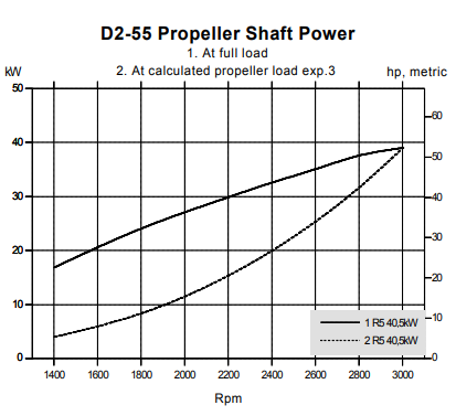

80% of 3000 rpm = 2400 rpm my14_d2-55.pdf (coastalmarineengine.com). As a comparison, my 40 hp Yanmar 3JH4E achieved hull speed at 80% of max 3000 rpm and my current 75 hp Yanmar 4JH3-TE achieves hull speed at 70% of max 3800 rpm.....maybe the later is not optimized?
