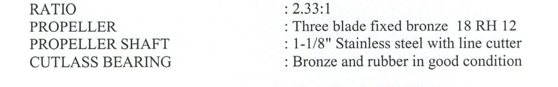

I recently purchased a Hunter 41 DS. 2009 with the option for the larger 54 hp engine. It currently has a 2 bald prop that I suspect was added after market. If you this same boat, can you confirm with me if it originally came with a 3 blade prop and if you know the size and pitch? Any information would be appreciated. Thank you. Dan
Oct 29, 2016
1,929
Hunter 41 DS Port Huron
This is a snip it of our 2007 41 DS Survey back in 2009
When we purchased the boat in 2016 the PO changed the original prop to a Flexofold
