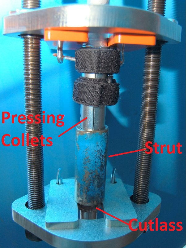

You may be able to get the shaft by the rudder by having a yard press out the cutlass bearing. The extra space after removing the cutlass can sometimes get the shaft to squeak by the rudder. You can buy a Strut-Pro but they are expensive for a one time job.

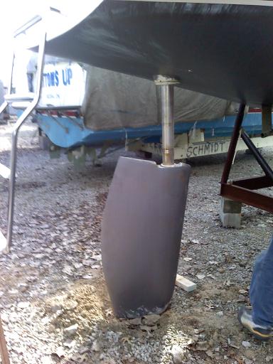

Last April I replaced my CB and found that the shaft could not be removed without digging a hole to drop the rudder or getting the boat yard to lift the cradle up for an hour or so and lowering the rudder that way. I was on "dirt" and dug a hole. None of the options presented are easy or fun. My CB lasted 9 seasons and I hope to never have to replace it again.

Last April I replaced my CB and found that the shaft could not be removed without digging a hole to drop the rudder or getting the boat yard lift the cradle for an hour or so and lowering the rudder that way. I was on "dirt" and dug a hole. None of the options presented are easy or fun. MY CB lasted 9 seasons and I hope to never have to replace it again.

If you go in on a Strut-Pro tool with some friends, owners association or your yacht club it can be a decent investment. All you'll need to do is pull the prop to replace the cutlass.
These tools can be purchased for not a lot more than you'd pay a yard to replace your cutlass just once. I think the C-34 and perhaps the C-36 owners association both own one that they loan out to members. Perhaps you C-310 guys could pitch in on one..

I just got a price from my marina of $300 for the CB replacement. This tool for our boats is $395 plus shipping and handling.
Just four members pitching in and you now have your price of a cutlass bearing replacement down to about $135.00. USPS flat rate boxes are a good choice to ship the tool cause it's heavy!
I own the full mac daddy kit and it's over 30 pounds..

Alternatively, you can make one yourself. I replaced my Cutless bearing using some 3/4" copper tubing, 2 pieces cut to the same length and then cut down the length and overlapped so they filled out to the dimension of the strut opening and pushed on the bearing outer wall. I put some host clamps around the outside so they would spread. Then with some threaded rod and some pieces of wood made a structure to put pressure and press the bearing out. Mine was pretty easy to replace without removing the shaft.
