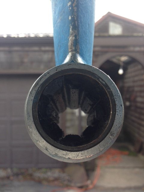

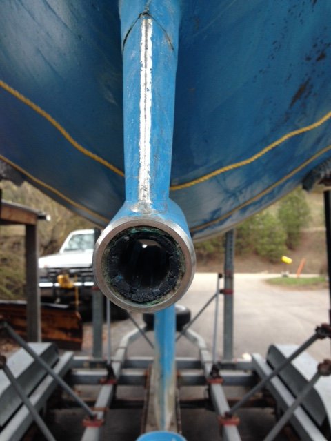

Shaft Bearing Removal
Any ideas on how to get this bearing out. The method submitted above did not work. I am trying PB Blaster and trying to chip out with a thin piece of fiberglass.

take a hack saw and saw a cut in it being careful not to cut the strut then when through take a fine chisel and start driving at the cut you should be able to get it moving that way
you have really got an ideal access to the bearing

There may be a metric Allen set screw on the left or right side of strut that holds bearing from spinning

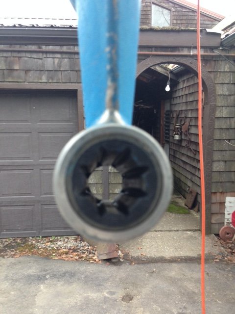

yes thanks for pointing that out ......i also looked at the pick again and it looks like the strut is stainless steel ...and also the bearing looks as if it could be a composite material instead of brass or bronze if it is a composite it should be fairly easy to saw

So, there is an inner composite ring of material adhered to the bronze/brass outer ring, correct? There should be a set screw keeping the bass ring from spinning, correct.

Keep trying to source the replacement and get one in hand to I-d what your taking out usually it's a bronze or nibral bushing
