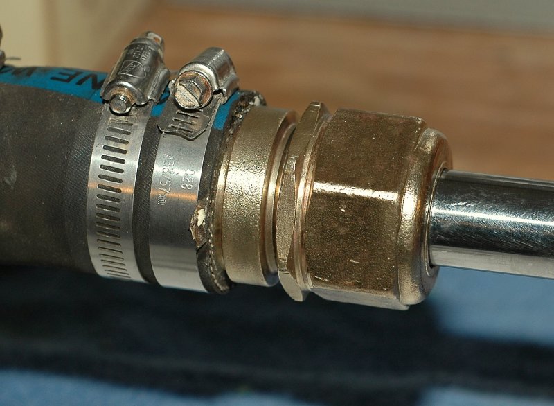

Your image is that of a Nylon/Plastic shaft stuffing box and shaft log.
Here is a great site with detail about the "traditional" stuffing box.
You can go to a bronze stuffing box. The stuffign box requires a few drops of water as you run the shaft. The drops of water help to keep the flax stuffing cool. They have been around for ions. They work well and are very serviceable.
You can also find what are called "DripLess" seals. PYI.com is one company that manufactures a shaft seal. There are others.
The best practice is often to change out the nylon stuffing box for something a bit more durable. The hose to the shaft log is there to keep water from running into the boat. The clamps should be maintained tight and inspected regularly for drips or corrosion. The hose looks to be in good condition. Double Clamping is the recommended best practice.

These glands "can" be maintained but are so cheap they should be removed and replaced with a bronze packing gland. See here for maintenance of a bronze gland and apply to yours :

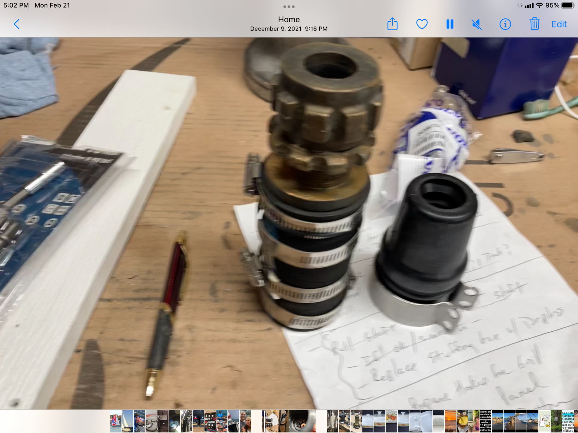

If you are going to do something with it, you might want to consider a dripless seal. There are several on the market. I use a Volvo Penta dripless lip seal. Works very well on my older O’Day 322. I replaced a bronze stuffing box.
The Volvo opened up some space in the shaft bilge!
if you keep your old one (or if you go with another stuffing box), be sure to replace that hose. And use hose by Buck Algonquin or another source made for this application (it is much heavier walled than radiator or sanitation hose).

3819724 is the Volvo part number I found for a 1” shaft and 1 3/4 stern tube. Is that same as yours?
Jan 7, 2011
5,884
Oday 322 East Chicago, IN
Yes, that is the only one for a 1” shaft. As I noted in my PM, you can shim the clamp if necessary, or add some glass to the stern tube if it is too small. But you are ordering the right part..
