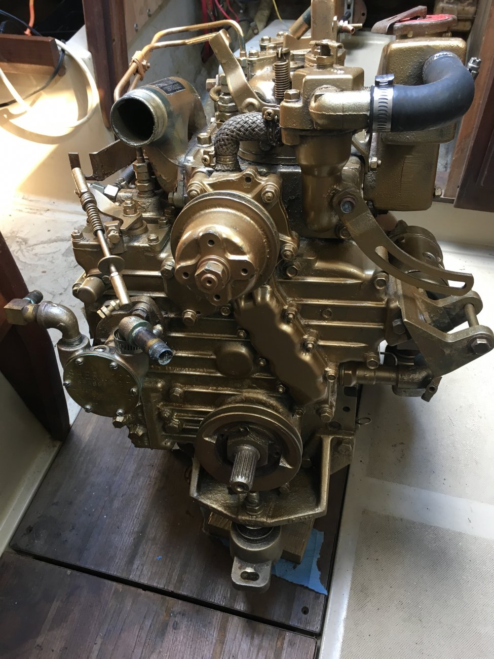

I've been working on this for a couple of weeks now. It just won't budge. Tension, heat, and PB Blaster. So I'm trying a different approach. Engine is half way out and needs to be hoisted. Prop will come off and then the shaft can be pulled out by way of under the engine. While out a new cutlass bearing and then with the new stuffing box hose and fresh stuffing in place it will be reassembled. While the engine's out of the compartment, a good wire brushing, a coat of paint will happen and then put back.

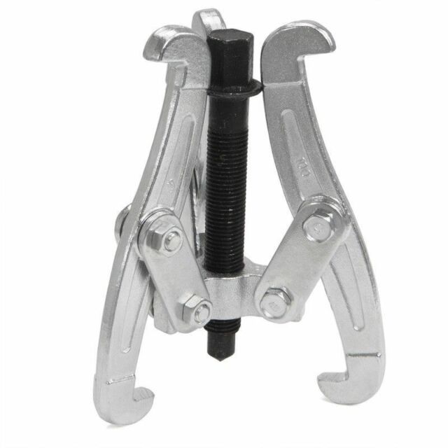

If you have the room, once the coupling is undone from the tranny, it is simple enough to use a 3-jaw gear puller and remove a sturdy coupling. Make sure the shaft is centered in the shaft tube so you can properly align it. Good luck
