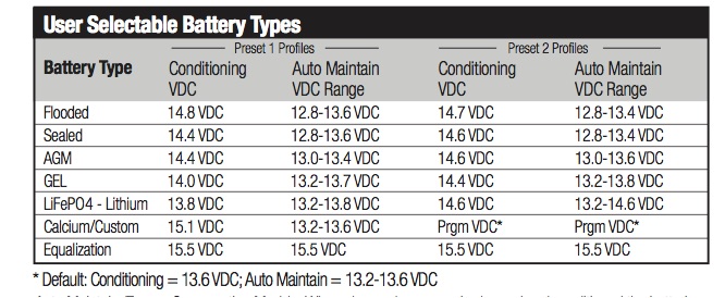

I sent the East Penn recommended charge profile to ProMariner and their response was either AGM Preset 1 or Sealed Preset 1. Here's the profile table.
Without getting into the custom mode, it seems that Flooded Preset 2 would be appropriate for my current use of the boat (mostly a dockside condo with some day sailing and a longer vacation trip) and when we set sail out the St. Lawrence shift to Flooded #1 to get the higher float charge when we have access to shore power.
