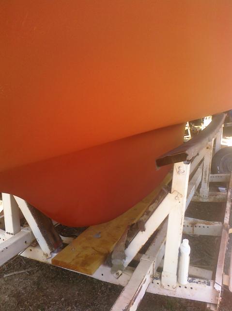

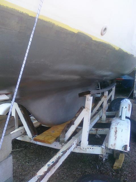

Up date:
Well all the best laid plans have gone awry. No paint yet, we even have the wrong kind of paint for trailering. We had the brushes and rollers at the ready and then I decided to read the can and found out that the paint that I had wanted was not sent to me. I had asked for a HARD
Dec 25, 2009
269
American 26 & MFG Challenger 12 American 8.0, Challenger 12 Lake Pepin, Wisc.
Up date:
Well all the best laid plans have gone awry. No paint yet, we even have the wrong kind of paint for trailering. We had the brushes and rollers at the ready and then I decided to read the can and found out that the paint that I had wanted was not sent to me. I had asked for a HARD paint for fresh water that would with stand the rigors of going on and off the trailer numberous times in a summer.
What I had was a Soft Abliative copper infused paint for anti fouling in salt water.
What to do? I called a friend who's life revolves around sailing (designer, builder) and asked him what to do.
It seems that since my below the water line is now clean of all the old paint, but is scuffed up with 80 grit paper, I would need to seal it again, since the gel coat was breached and that old 70's sailboat were prone to blistering. While my boat has no blisters, by sanding with 80 grit, I have made it vulnerable to blistering in the future unless I seal it.
He recommended Epoxy Paint.
Later on he emailed me and had the brand EasyPoxy to recomend it is a one part Epoxy (polyurethane sealer/barrier paint). Since I already had a gallon of High Gloss White EasyPoxy I was going to use on the interior, our plan today is to pressure wash the hull today and paint with the EasyPoxy tomorrow.
It is raining today and that would seem to be a good time to wash it while it is already wet.
We will see....
