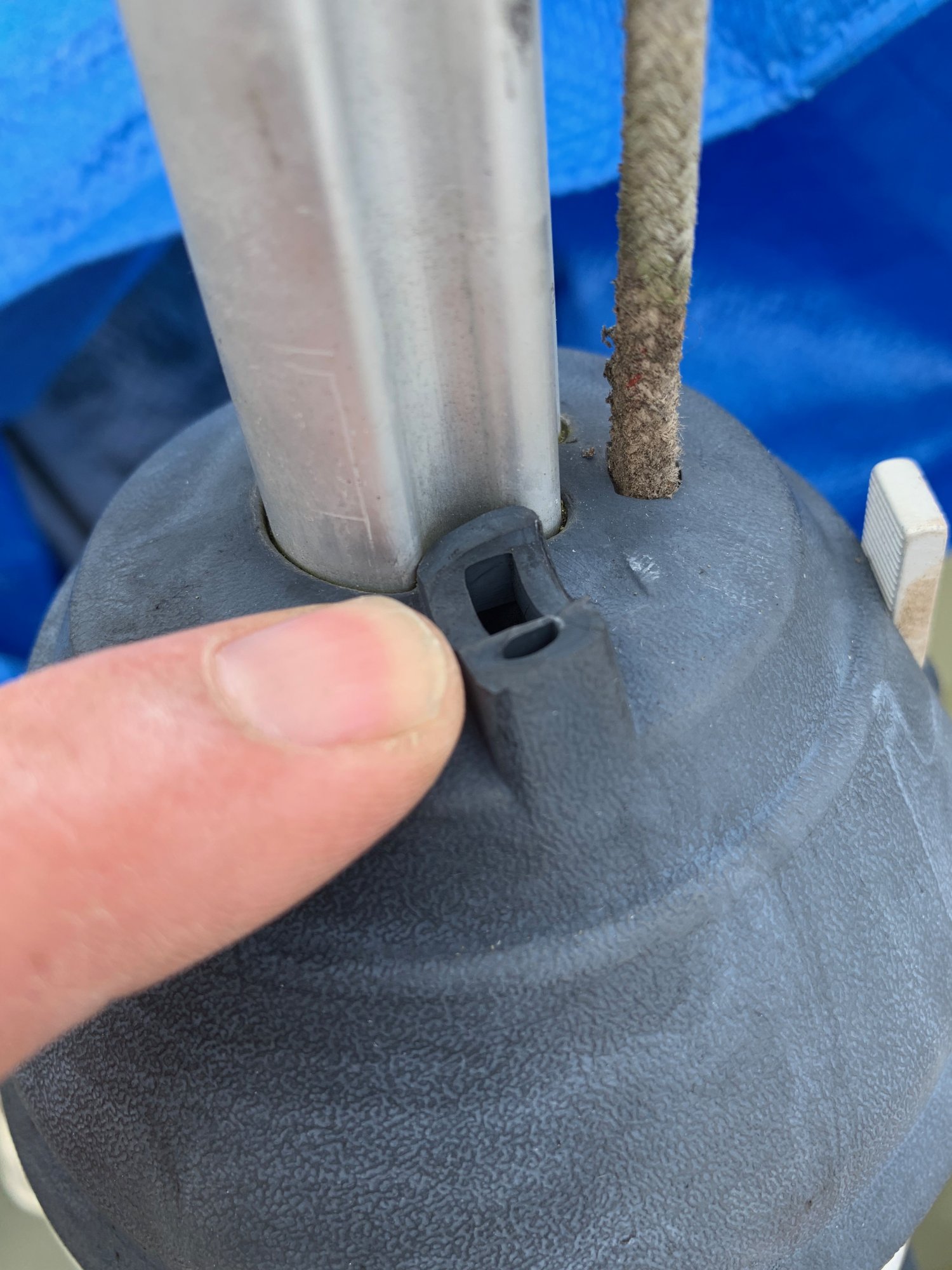

I have a Hunter 25.5 (1984) with a ProFurl S26. The housing on the furler is a plastic like material that had an eyelet integrated into the top of the housing for attaching the sail. I don't know what a material is for sure. I am looking for an epoxy or similar material that would bond a metal eyelet into this housing. I talked with 3M and they suggested asking a sailing forum since they didn't know the exact material.
Is anyone familiar with this ProFurl S26 and know the material? Or, do you have a suggested bonding agent?
Any ideas would be appreciated.

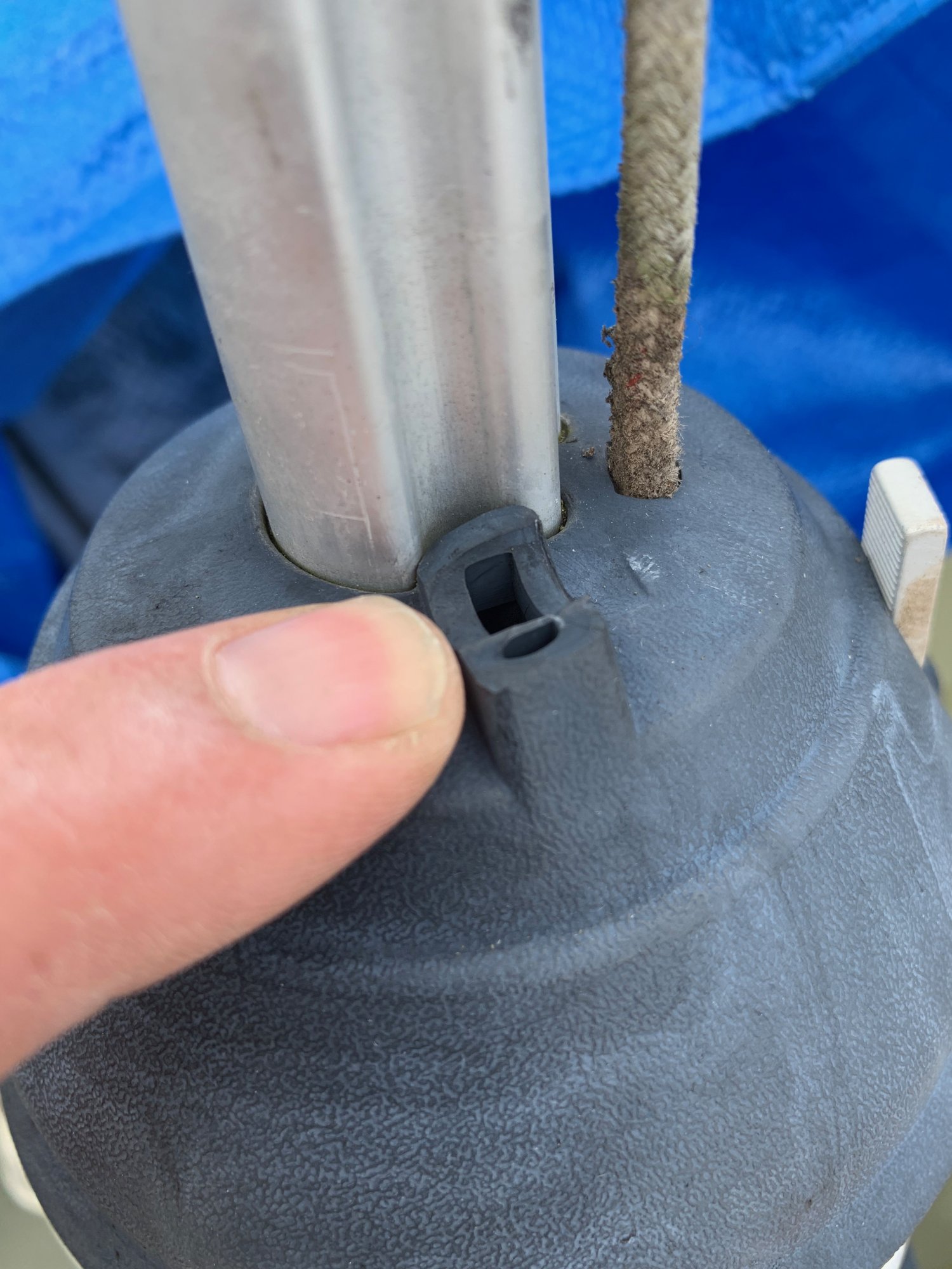

Looks like there still enough material there to drill and install a 3/16" pin or clevis. Right where u pointing
12,593
Do you still have the piece of plastic that broke off? If so, I'd JB that back on and if some oozes into the hole, you can drill that out.

I had a profurler system. Your part is different then the one I had. I am trying to understand the part you are looking at and what the broken plastic piece did. It looks like the piece is the swivel to raise the sail. Is that correct? If so to what did you connect the plastic part to? How was it used? This could give you clues to the importance and the strength needed for the glue.
Jan 25, 2019
19
Hunter 25.5 Weiss Lake
Brian.
It is were the Tack of the jib attaches to the furler with a shackle. The part missing would have been a simple loop/eyelet for the shackle to attach.
The image is the top of the spooling housing and just below out of view would be the actual spool for the line.

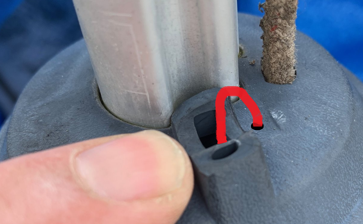

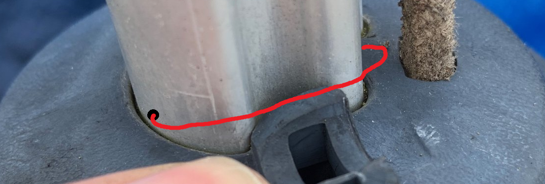

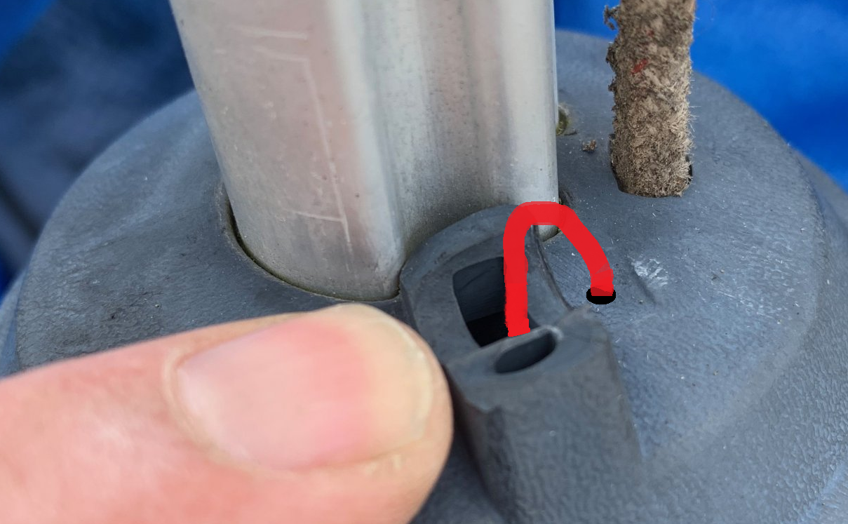

Maybe we are making this harder than it needs to be. If all you need is a place to tie-off the tack of your headsail then maybe just drill a hole in the base (see pic) and run a loop of dynema (or strong nylon) and attach the tack of your sail to the loop using a small ss-shackle or snap hook.
That was one of our first ideas. The interior structure has baffles for strength, which prevented us from doing that approach. We have also considered perpendicular hole through the area to hold a loop or other hardware.
We have a concern about removing too much material and loss of strength. Plus, we don't know the full interior design of this part.
12,593
:thumbup:
12,593
Maybe a loop of dynema or a small diameter ss cable like what is used for rigging here... chafe would probably be an issue with dynema and the ss cable might saw through your aluminum. Back to JB weld?
23,265
Brian
