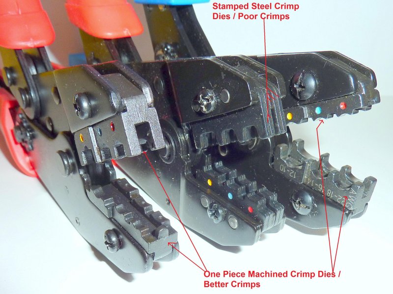

L-R; The original crappy HFT crimper, the new model, and the Ancor:
Die measurements are close to the Ancor:
These are the actual measurements at full crimp measuring the crimp jaw not the strain relief jaw.
Ancor = Yellow 3.29mm, Blue 2.72mm, Red 2.19mm
HFT = Yellow 3.39mm, Blue 2.81mm, Red 2.30mm
Despite the HFT being nearly .1 mm off across the board, the crimps were strong and resisted more pull out strength than is required to meet the ABYC requirement.

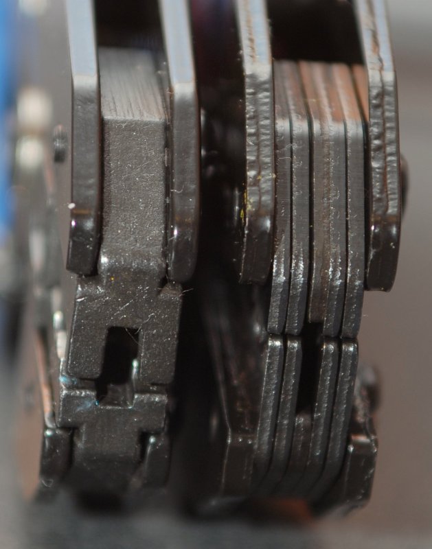

How do you differentiate stamped vs machined?
Good review, but how exactly can we tell if the dies are machined or stamped? Does one have cleaner edges or something like that?
Feb 6, 1998
11,703
The one on the left is a one piece machined die. The one on the right is made up of five pieces of stamped steel stacked together to make a crimp die.
The one in the middle is the one you don't want. Note the steel plates making up the crimp dies vs. the one piece machined nature of the other two..

The HFT with the steel dies makes a poor crimp and yes the tolerances on the steel die version are quite poor. I can actually consistently pull out the wire when using the smaller gauge wire size for the given crimp connector.
Also because of the steel plates, and the inability to properly space the plates for the 10-12's (yellow), the strain relief crimp winds up in the wrong spot.
The HFT with the one piece dies makes a far better crimp than the steel plate Taiwan model. While not the quality of the Ancor, the Chinese model it is a fairly decent crimper at a very fair price..
